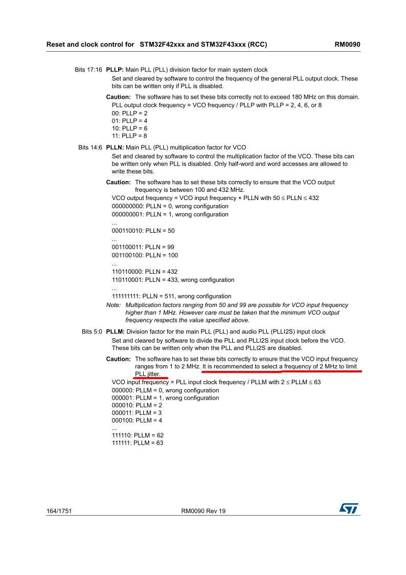

For some families' PLL, there may be some preferential setting, e.g. for 'F4:
0693W00000aIaczQAC.pngFor 'G0, there may be no such stated preference, I did not search. In that case, any combination which obeys the limits for PLL's VCO and dividers, given in DS, will do.
Note, that PLL is to large extent analog and such preferences change from family to family because of different technologies and PLL component designs used, so such preferences are not transferrable.

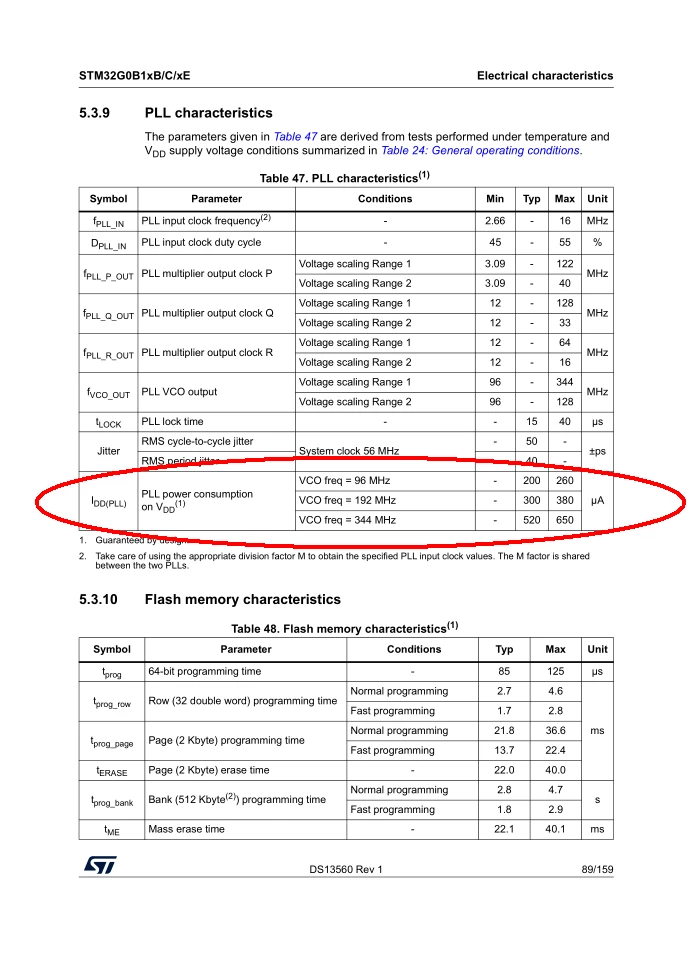

PLL settings may also influence current consumption, within limits given for the PLL module.

A general note... With everything else being equal, one should strive to minimize the numeric values of all multipliers and dividers.
