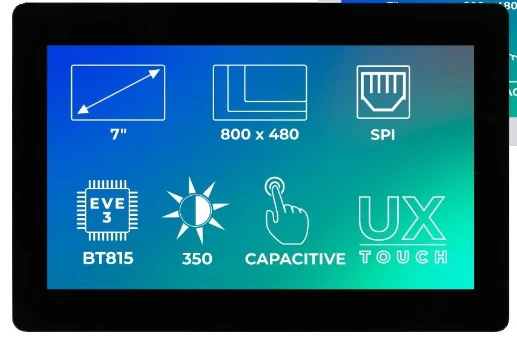

i would use some TFT with EVE controller + RAM onboard;
only need SPI connection to display - easy to do.
see:
https://www.matrixorbital.com/eve-bt817-bt818
and driver lib (i use the lib from Rudolph..running fine.)
https://github.com/topics/eve4
many can buy at mouser:
https://www.mouser.de/c/optoelectronics/displays/lcd-displays/tft-displays-accessories/?series=EVE3
https://www.mouser.de/ProductDetail/Riverdi/RVT70UQBNWC01?qs=B6kkDfuK7%2FDDeOIzd3ETzg%3D%3D
