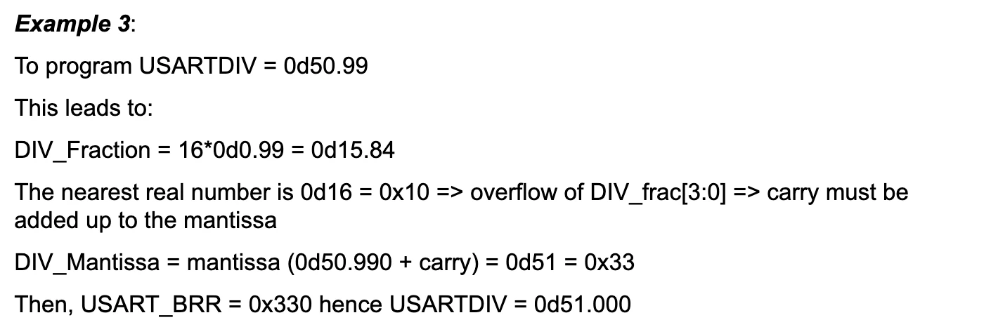

July 10, 2024
In the documentation stands something about, if the fraction is too big for the 4 bits then the "carry" must be added to the mantissa.
But I don´t understand what the "carry" of 0d0.99 is? Because they simply round up the 0d50.990 to 0d51. :thinking_face:
