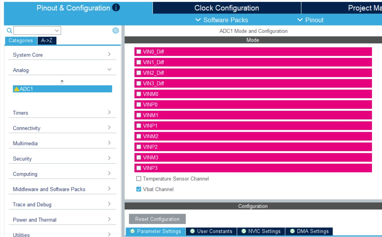

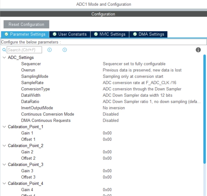

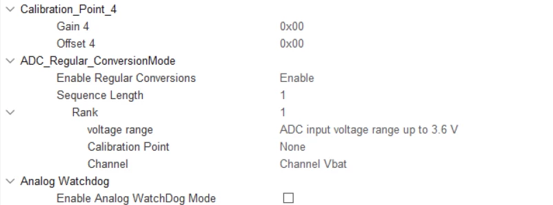

We took cue from the ADC_Downsampling example from MX to write our Vbat measurement code.
We are getting very small values of raw adc data - somewhere always between 0x160 and 0x200.
We are using a coin cell with 3.3V nominal and are naturally expecting codes in the range of 3000 - 4000 (decimal format).
I have attached our code and the MX configuration here. Can you please help us understand where we are going wrong?
