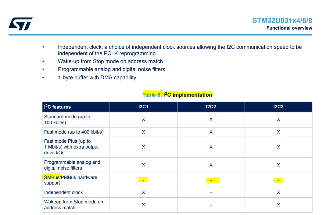

Battery charger SMBUS interface to STM32U031R8
Can I interface SM Bus of battery charger chip to one of the I2C port of STM32U031R8? If yes, what care I need to take from hardware perspective?

Hello @PPate.1
As mentioned in the datasheet, the I2C on STM32U031 does not support the SMBus feature.
Thank you.
Kaouthar
