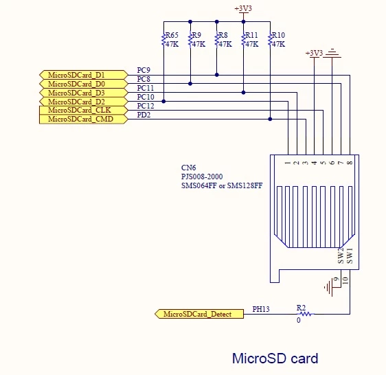

    Ok, so I finally got the example to compile and I uploaded to my board with some modifications (I changed the SD detect pin to D11 in stm324xg_eval.h and I changed the on-board led pinout to match my board) but it's still not working properly.
    Most of the time it gets stuck in a flag check loop somewhere in SD_Init before led 4 can turn on. Sometimes led 4 turns on indicating that something went wrong (after some debugging it seems that the SD card is recognized as an MMC card and then receives an illegal command), and very rarely it erases the first 100 512 byte blocks and gets stuck somewhere after that. Never have I gotten the leds 1, 2, and 3 to turn on (indicationg that is got to the end of the example successfully). After looking through the example it looks like SD_EraseTest should execute which, as the comment states, ''Erase NumberOfBlocks Blocks of WRITE_BL_LEN(512 Bytes)''. Number of blocks is defined as 100 so in theory it should just delete the first 51200 bytes of the card, which is where the MBR resides hence Windows telling me that the card isn't formatted after a successful run. Looking at the card with a hex editor confirms that the data was erased. So really I just need to figure out why it's being so unreliable right now. I don't have pullups on any of the pins which might be the problem. I've tried reducing the init and transfer clock speed but that didn't help.

    Will definitely break without pull-up resistors. 33K or 47K will suffice. You'll need to pick your own card detect pin.
    I've posted the MSC and FatFs examples to the STM32F4-Discovery with a MicroSD socket. These have been posted against the forum several times.
    https://docs.google.com/open?id=0B7OY5pub_GfIcU1XTDFDRlptZDg
    https://docs.google.com/open?id=0B7OY5pub_GfIaUozb1VsY3Flb1E

    Ok, I added the pullups and it worked a lot more reliably (erased the first 100 blocks every time) but it was crashing somewhere just after the block erase. I was debugging and found that it made it through SD_ReadMultiBlocks (right after the block erase), but at that point TrueSTUDIO decided to crash and give me a blue screen. Now for some reason I'm getting stuck in the flag check loop in SD_Init again, specifically this:

    After some more testing I've found that I get corruption on transitions between the states of the data lines. For example, if I read 0x0F (which, in 4 bit mode, is 0000 transitioning to 1111) then I get corruption. If I read 0x0E, however, there's no problem. This lead me to believe that my pullups weren't strong enough (even though they were 10k) so I went all the way down to 470 ohms. While this did make 0x0F read correctly I still can't read 0x00 followed by 0xFF and there's no way that my pullups should be that strong. Without an oscilloscope I have no way of knowing what the rise/fall time of the data lines is etc. I don't know how useful any of this information is but if anyone has a clue as to what's going on please reply.
