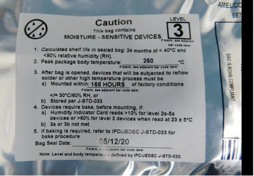

Base on our previous record, JEDEC standard shelf life is 12 months. But recently we received the part STM32F103ZCT6 shelf life is 24 months. Please help to advise on this.

Likely relates to how effectively the bag is packaged and sealed​, sort of question you'd ask your sales on engineering support contacts directly.
I'd expect the performance of the packaging from the facility has been evaluated to arrive at these recommendations, if you have tighter procedures, apply those, or consume the materials more quickly.​
