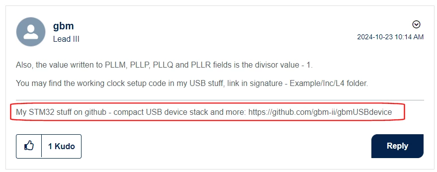

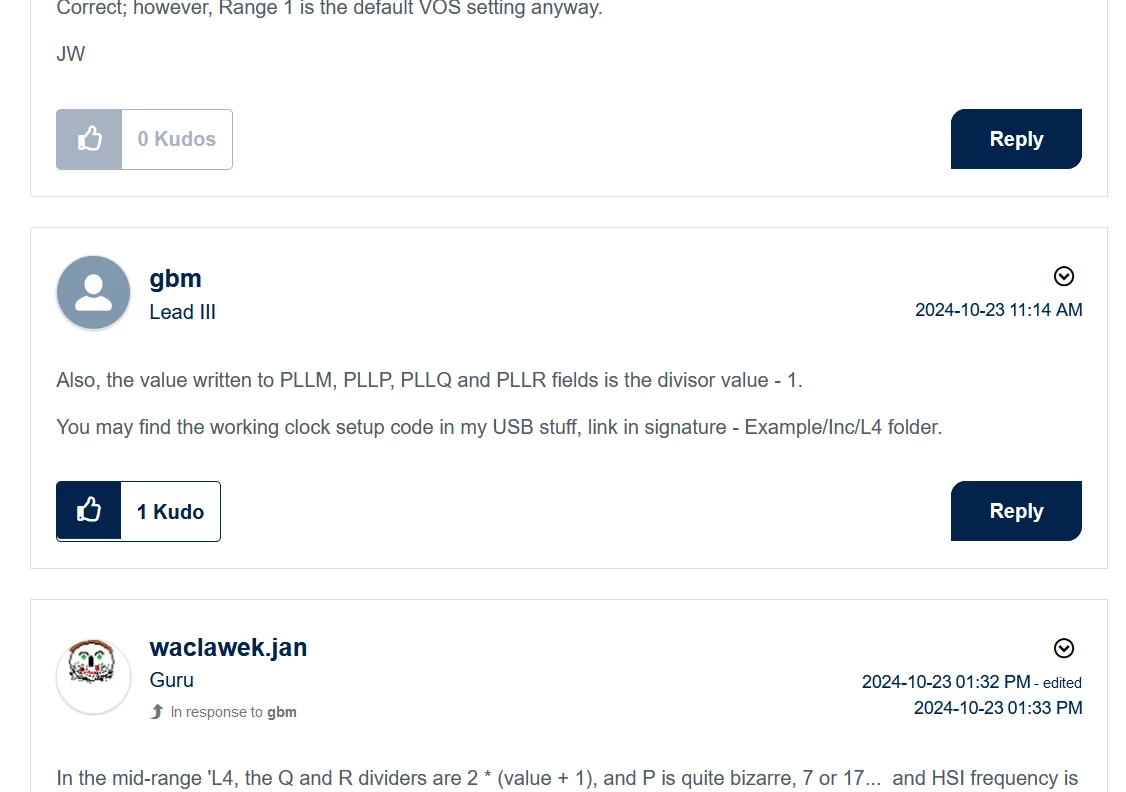

Also, the value written to PLLM, PLLP, PLLQ and PLLR fields is the divisor value - 1.
You may find the working clock setup code in my USB stuff, link in signature - Example/Inc/L4 folder.
My STM32 stuff on github - compact USB device stack and more: https://github.com/gbm-ii/gbmUSBdevice
waclawek.jan
October 23, 2024
In the mid-range 'L4, the Q and R dividers are 2 * (value + 1), and P is quite bizarre, 7 or 17...  and HSI frequency is 16MHz. These things tend to change from STM32 to STM32 (sub)family.
> link in signature
I don't see any signature in this thread (https://community.st.com/t5/stm32-mcus-products/bare-metal-stm32l496/m-p/734800 ).
Andrew Neil
October 23, 2024
@waclawek.jan wrote:
> link in signature
Here:

waclawek.jan
October 23, 2024
Interesting. I don't see it.
But by this point I gave up any attempts to comment on the state of affairs; it's just waste of time and energy. I have better places to be ignored.
waclawek.jan
November 12, 2024
I was wrong about the signature, and it's my fault.
I've been approached by an Admin who told me, that I have switched off displaying signatures in my settings - which I indeed have done back then when Khoros was new, in order to decrease visual noise and try to squeeze in as much relevant information on a screenful as possible - and have forgotten about it since then.
(And I've been also confused by the fact that I do see signatures, when I am not logged in.)
