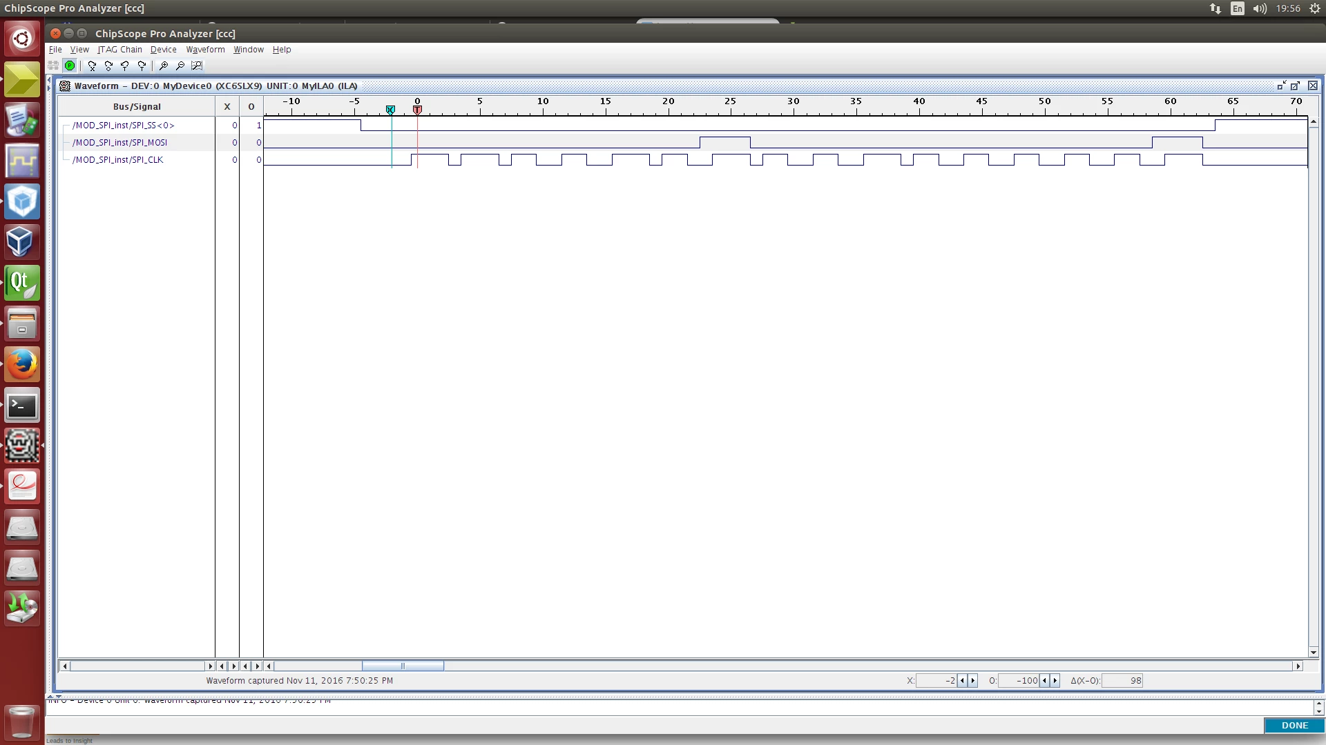

Hello. I have got stm32f746 and I make project with cubeMX.
I  want to use SPI4, SPI5, SPI6 as fullduplex master with 50Mb/s baudrate.
Then I try to
HAL_SPI_Transmit(&hspi4, pData, 1, 30000);
in while(1) cycle. Data has been sent, but the clock is very bad.(I put image in attachment. You can see there.)
As you see, duration is not 50%. When I set baudrate less then 50Mb/s, may be clock is good, but I need only 50Mb/s.
Is this my fault, or this is bug?

    What's your LA's sampling frequency?

    Make sure the GPIO speed is setup to high frequency. You might check the signal quality with the optional pull-up mode.
    The duty cycle of the clock signal probably depends on the SYSCLK and prescaler values (1/2, 1/4, 1/8, etc...)
    50 MHz requires careful PCB lines and probably a serial resistor to avoid ringing. Also make sure to use if possible 4 wire mode and not 3 wire bi-directional. Definitely DMA will have to be used for good average data throughput. (6 channels, as you'll need a TX and RX channel for each SPI if they are used concurrently).
