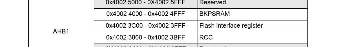

someone knows where the Backup SRAM is located on STM32H563 (at which address)? I didn't find it in the documentation.
Thanks
Best answer by GwenoleB
Hello @Ez_it ,
Backup SRAM starts at address 0x4003_6400 to 0x4003_73FF (Non-Secure)
or
0x5003_6400 to 0x5003_73FF (Secure)
I will ask to add it inside the Reference Manual.

jerry_sandc
November 29, 2023
i have same question about STM32F7 !
the Backup SRAM address is not listed in the RM0410 Rev 4
AScha.3
November 29, 2023
see ds , p. 104
jerry_sandc
November 29, 2023
correct, i found after i posted  :face_with_tears_of_joy:
just difficult to find since not listed as 'backup SRAM' (instead of BKPSRAM)
