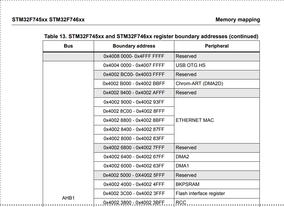

Does someone know where the Backup SRAM is located on STM32F746 (at which address)? I didn't find it in the documentation (RM0385).
Thanks !

Hello @bluexav

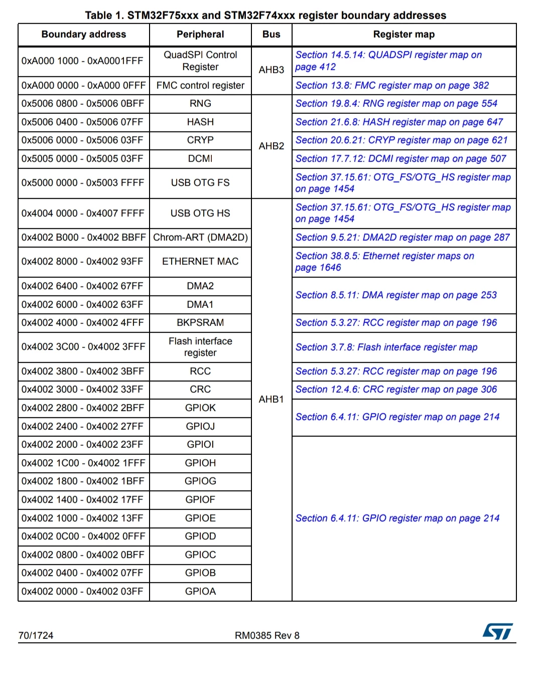

The Backup SRAM is located between the following address : 0x4002 4000 - 0x4002 4FFF as indicated on the RM0385:
Best Regards.

Thanks to both of you for your immediate answers ! I was looking for it in the wrong table (memory map) and was surprised that this RAM didn't appear in system architecture drawing.
