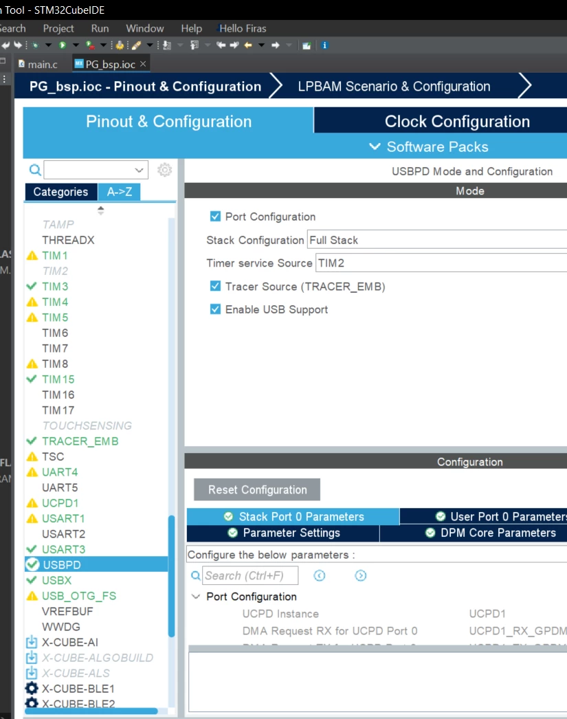

I'm trying to setup my B-U585I-IOT02A as a USB host.
Ive turned on the following:
  • USBPD - Type C only, TIM2, enabled USB support
  • USBX - core, Host CoreStack FS, Host Controller FS, MSC
  • USB_OTG_FS - Host Only
  • UCPD - Source
  • FileX - FileX Core
to initiate I've used these in my main:
MX_USB_OTG_FS_HCD_Init();
ux_host_stack_hcd_register(_ux_system_host_hcd_stm32_name,_ux_hcd_stm32_initialize, (ULONG)USB_OTG_FS,(ULONG)&hhcd_USB_OTG_FS);
It seems I don't get the any power out to my USB flash drive, and the USB event callback doesn't work.
am I doing something wrong? am I missing something? thanks in advace

Hi @ElectroManiac
You may need to share the full project. According to your IOC, you are using full stack configuration for USB PD application not type C only as you mentioned in initial post.

July 17, 2024
@FBL its because I kept trying to make it work, after a couple of days of trying to make everything compile I succeeded but the "ux_host_event_callback" doesn't activate, and the UCPD software still doesn't recognize the board/app
