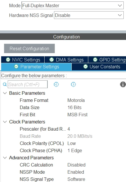

and this is SPI setting of the microcontroller:
0693W00000Y7ZHMQA3.pngHere is the sample output of a udp server i wrote in python:

as you can see connection starts and stops working intermittently and apparently there is no pattern for this events.
I've tried every trick that i could come up with, like closing and opening the connection and putting delay between sending consecutive packets, but none of them solved the problem for me.
I really appreciate any help for solving this problem.
