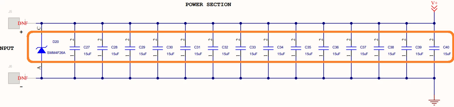

B-G431B-ESC1 Max voltage
Is it possible to input 7S into a B-G431B-ESC1 EVM with a voltage specification that says up to 6S?
If not, if I replace some parts with a high rated voltage as below, can I input 7S into EVM?
 1. Power Section, TVS diode, SMM4F26A (D20) -> SMM4F33A
 2. Power Section, Capacitor, 15uF 35V (C27 to C40) -> (I will keep this.)

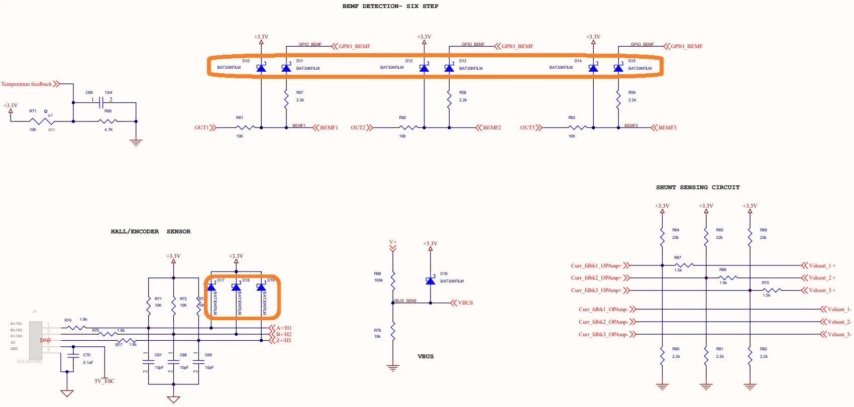

 3. Bemf Detection & Sensor Input, Schottky diode, BAT30KFILM (D10~D15, D17~D19) -> BAT48
Thank you!

ChoibogueAuthor
October 29, 2024
I saw your previous reply in the thread you linked.
If you ask me if I want to do it because I have a lot of work to do, like your previous reply,
I will do it. (even if I make custom PCB...)
What's important to me is,
can ST or equivalent guarantee that if I change EVM like this without any problems, I can safely achieve my goal(use 7S battery).
So, in order to input the voltage up to 30V, is it correct that I understand as below?
3. Bemf Detection & Sensor Input, Schottky diode, BAT30KFILM (D10 to D15, D17 to D19) -> BAT48 ??? (Does this have to be replaced as mandatory? Or can I just leave it?)
4. I don't need to modify the L7986 related circuit. It originally supports up to 38V. However, I need to check the  voltage spec of C41, the input capacitor.
5. I need to change the voltage divider R68/R76 value for VBUS monitoring.
Richard Li
Senior
October 29, 2024
Hi, Choiboque,
Your maximum input voltage for 7S isn't right.
Do you know Lipo battery can charge to 4.35V for one cell?
Normally, design should give at least  +/-10%,
So if you want your design safe enough, you need count  7s for 4.35 * 7 *.1.1 ~ 33.5V.
