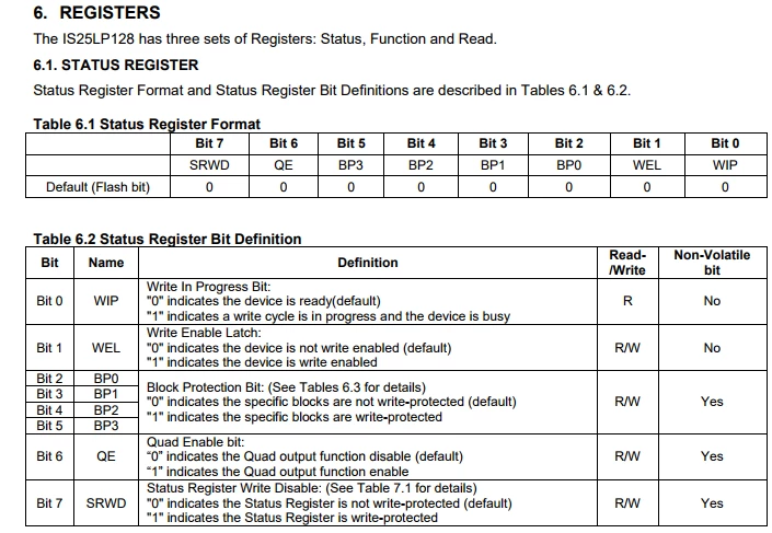

I have a problem. I erase external memory. But this procedure last long time. So I set autopolling mode with interrupt. But It doesn't work.
When I send erase command I need wait on WIP bit in status register. And when QIP bit is set, I need generate interrupt.
And program work:
  1. Send 0x06 - enable write to memory
  2. Send erase memory 0xC7
  3. Set autopolling mode
And when I set autopolling mode, immediately is generating interrupt. And it is wrong.
Any idea, what is wrong?

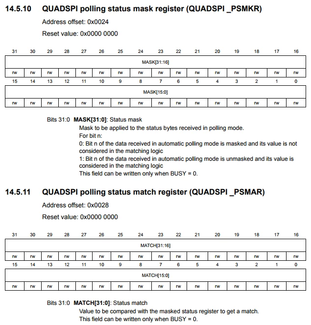

QUADSPI polling status mask register (QUADSPI _PSMKR)
QUADSPI polling status match register (QUADSPI _PSMAR)
Mask and stencil for checking the flag in automatic mode of infinite reading.
PSMKR - the mask resets all the irrelevant bits when reading the flag, PSMAR performs the XOR operation with the result = if there is a complete match, the interrupt will occur. Any other value that does not match the mask and the stencil is ignored.

Mask and stencil are applied to the full width (it is desirable).
Memory responds in a loop all the time, it's not one byte - but 4. It looks something like this:
mask 0x01010101 - the remaining bits will be reset
stencil 0x00000000 - wait for the answer to match (your case is now 0x01 -> expect 0x00).
If you want to control two bits or more - they all need to get into the mask, even if they are at the start zero.
The mask is a binary operation '&', the stencil is a binary operation '^'.

for check WIP bit I used:
QUADSPI->PSMAR = 0x00000000 ;
QUADSPI->PSMKR = 0x01010101 ;
but for check WEL bit I used:
QUADSPI->PSMAR = 0x02;
QUADSPI->PSMKR = 0x02;
Can anyone describe the use of PSMAR and PSMKR?

There is no point in understanding, there are a lot of conditions and confusion. It is much easier to read the answer in a simple way, it will look exactly like this - how you need to process it. The status response always has a size of 8 bits, and it repeats in a loop until a clock signal is sent to the memory chip. (First, you need to give the status reading command.) But the answer may differ from the documentation, primarily externally. A WIP can be the first least significant bit, or maybe the most significant bit. I abandoned the idea of guessing, it is easier for me to consider the answer from the debugger.
You got a cast, and WIP is in the low bit. In this case, you need to reset everything except PSMKR 0x01010101. Now you can catch the necessary condition for you WIP = 0 PSMAR = 0x0, WIP = 1 PSMAR = 0x01010101.
