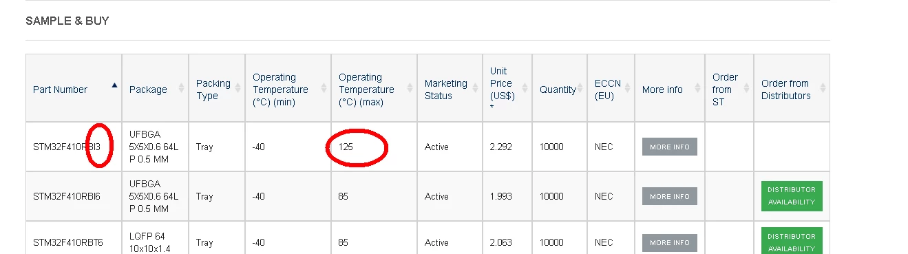

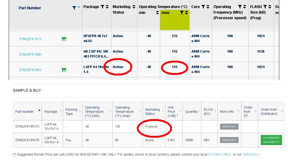

    waclawek.jan
    April 5, 2017
    Posted on April 05, 2017 at 10:33
    complete list
    /external-link.jspa?url=http%3A%2F%2Fwww.st.com%2Fcontent%2Fst_com%2Fen%2Fproducts%2Fmicrocontrollers%2Fstm32-32-bit-arm-cortex-mcus.html%3Fquerycriteria%3DproductId%3DSC1169%24%24962%3D125%7C125
    I have used the same filter on that table. Sadly, it does not indicate real availability at the ''garage-scale'' distributors.
    And not only that:
    I understand why, it's just that it's again misleading and does not help in searching.
    I don't try the ''selector'', as I won't install Java (wonder why would that need to be so).
    Amel NASRI
    May 22, 2017
    Posted on May 22, 2017 at 16:11
    Hi Jan,
    The selector is behaving in a way that it marks a line as active as soon as at least one given device belonging to this line is active.
    This is the case for STM32F413RG.
    -Amel
