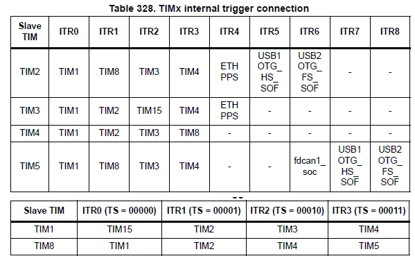

0693W000000WoNdQAK.pngOne trigger is fine for me. I still can reconfigurate the stepper driver to only act on a rising edge.
I attached the matrix from the RM.
I could take Tim8 as slave for Tim2 via ITR1 and take Tim5 as slave for Tim1 via ITR0.
I put both timers in "External clock mode 1" and then they should count up on every event. This sounds nice.
I will try this tomorrow (I will give feedback then, it is pretty late here right now).
Thanks alot
