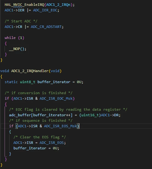

Hello Community,
I'm currently programming a framework for the STM32F3 ADC. However I ran into a problem. I want my ADC to run continuously. Moreover I expect "long" delays between reading the channels. I thought, this is no problem, since the ADC has the Auto Delay functionality. I attached a similar program flow and like my real program, the EOS flag is always set after the delay and only buffer[0] is written. I already searched the reference manual as crazy. Can someone see my fault?
Regards

Does it work if you take out the HAL_Delay(1); line? Probably all the conversions are overwriting each other. You need to use DMA for multiple channels, or be more responsive to the EOC flag.
schellek
schellekAuthor
July 30, 2020
Hmm, no it doesn't actually. It worked as I used (EOC-) interrupts for it, however I want this to be independent from DMAs and Interrupts
schellek
schellekAuthor
July 30, 2020
This code works. But I really don't get it. I thought the Auto Delay waits with the next conversion until the DR is read (EOC flag cleared)

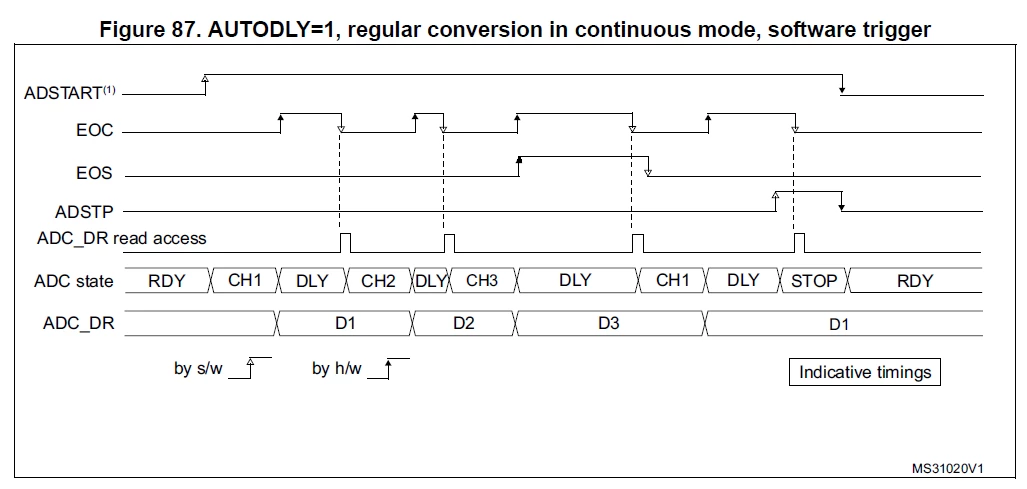

July 30, 2020
This figure suggests your original logic would work just fine:
Probably something else you're missing.
I wish the F4 had the same functionality.
waclawek.jan
July 30, 2020
>> Don't you observe it in debugger?
> I do
Okay so that's why the conversion doesn't stay in the DLY state - you read out ADC_DR by the debugger, thus clearing EOC. Exactly as in the "classical" case of UART and SPI I am talking in that link, and discussed here so many times.
Stop observing ADC by debugger, observe only the memory where the program writes the data.
