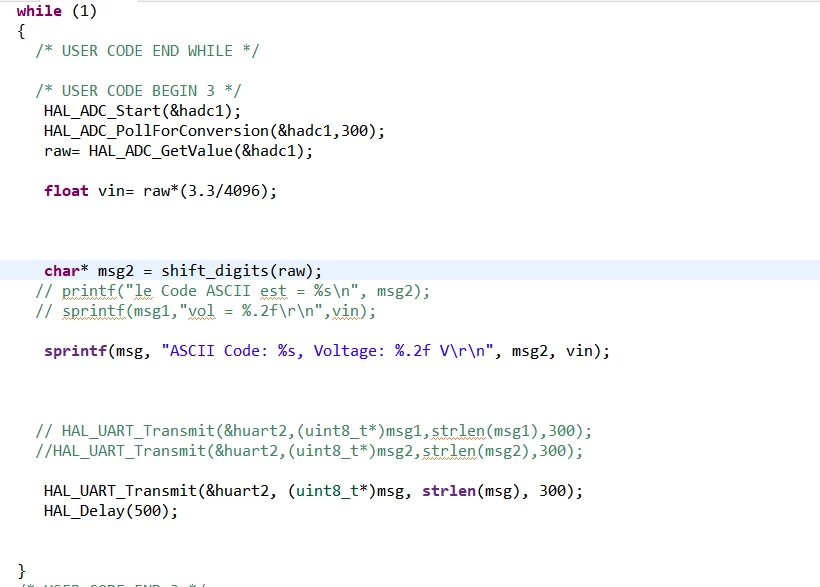

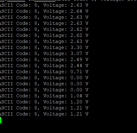

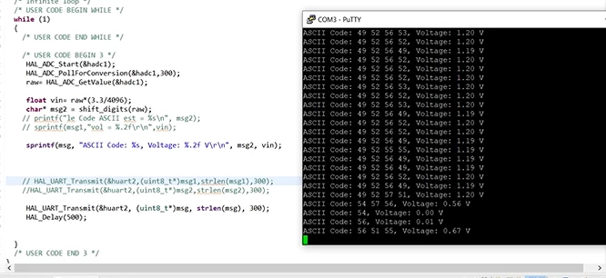

when i downloaded the code from cube ide and then try to visualize it with putty it works perfectly but when i moved the project to keil and then download it from there i didn't got the same result ascii is stuck at number 8 and it's not showing the write output related to volatge what should i do ?? , do i need some new configurations on keil cause i'm not getting any error neither warnings !!!!
here's the function of to convert an integer to ascii :
char* shift_digits(int input_integer) {
// Convert the integer to a string
char input_str[20]; // Assuming a reasonable maximum length for the string
sprintf(input_str, "%d", input_integer);

Do you ever bother to free() the malloc() ?
Check startup.s for Heap size, check you don't get a NULL returned, and free() the allocation.
Perhaps consider using a static allocation you can return.
ie static char result_str[32]; in the function

yasss thank you !!
i added :  free(msg2);
and it works perfectly!
