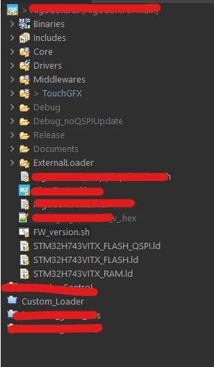

I found a solution.
This is based on git "bash.exe" command. The follow instructions show you how I obtaine my scope in only few steps. For first I create a sh script calles "FW_version.sh", and I placed on the project root:
the content of "FW_version.sh" is the follow:.
#!/bin/bash
export LC_ALL=en_US.UTF-8
# Path to the config.h file
HEADER_FILE="Core/Inc/main.h"
# Path to the build output
BUILD_DIR="Debug" # or "Release", depending on your build configuration
OUTPUT_FILE="${BUILD_DIR}/TestProject.hex" # Adjust to match your output artifact
# Extract the GUI_MAJOR_VER, GUI_MINOR_VER, and GUI_LETTER_VER values
echo "Extracting GUI_MAJOR_VER..."
VERSION_MAJOR=$(grep -oP 'GUI_MAJOR_VER \s*\K\d+' "$HEADER_FILE")
echo "Extracted GUI_MAJOR_VER: $VERSION_MAJOR"
echo "Extracting GUI_MINOR_VER..."
VERSION_MINOR=$(grep -oP 'GUI_MINOR_VER \s*\K\d+' "$HEADER_FILE")
echo "Extracted GUI_MINOR_VER: $VERSION_MINOR"
echo "Extracting GUI_LETTER_VER..."
VERSION_LETTER=$(grep -oP 'GUI_LETTER_VER \s*\K\d+' "$HEADER_FILE")
echo "Extracted GUI_LETTER_VER: $VERSION_LETTER"
# Check if all version values were found
if [ -z "$VERSION_MAJOR" ] || [ -z "$VERSION_MINOR" ] || [ -z "$VERSION_LETTER" ]; then
 echo "Error: One or more version constants not found in $HEADER_FILE"
 exit 1
fi
# Construct the full version string (e.g., v_1.23)
VERSION="${VERSION_MAJOR}_${VERSION_MINOR}${VERSION_LETTER}"
# Define the new artifact name based on the extracted version
ARTIFACT_NAME="${BUILD_DIR}/TestProject_v${VERSION}.hex"
# Rename the generated firmware (I.E. firmware.hex -> firmware_0.13.hex)
if [ -f "${BUILD_DIR}/TestProject.hex" ]; then
 mv "$OUTPUT_FILE" "$ARTIFACT_NAME"
 echo "Firmware renamed to: $ARTIFACT_NAME"
else
 echo "Error: Compiled FW not found"
 exit 1
fi

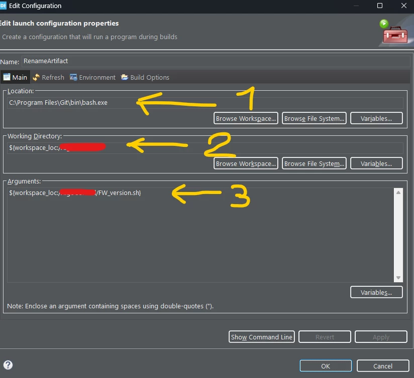

Second step is to create a new builder and inserting it into the project:
So, right click on the project, properties --> Builders --> New.
Compile the step 1,2 ,3 with your preference:
"1" is the "bash.exe" program present on GIT folders
"2" is your project folder
"3" is the script locations (I.E. = ${workspace_loc:/TestProject/FW_version.sh}  )  [pay attention to the syntax]

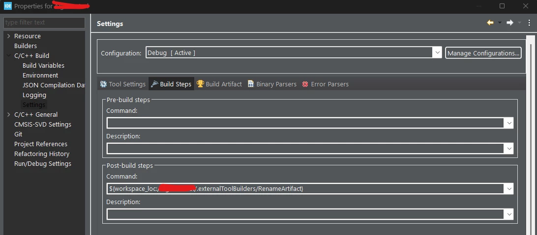

Last step is compile your post-build command with : ${workspace_loc:/TestProject/.externalToolBuilders/RenameArtifact} [pay attention to the syntax]
if everything works correctly, when you compile your code you will obtain the following result:
(in my case I used the script on the debug configuration. if you need, change it to release or something else configuration).

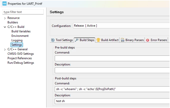

Pavel A.
Mar 28, 2025 3:19 PM UTC
Apologies for been not clear enough. There are no ready examples of such scripts. I only said that we can use the normal "unix" shell tool, even on Windows. Which is easier than dreadful bat files.
The post-build command goes into the project settings:
As you see, CubeIDE variables can be used in the commands, with ${...} syntax.

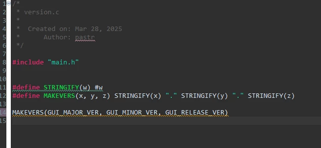

To get the version as string: make a small C file, for example ver.c  ver.h  [edited - use .h suffix so that Eclipse won't add it to the project as a source file]
#include "main.h"
#define STRINGIFY(w) #w
#define MAKEVERS(x, y, z) STRINGIFY(x) "." STRINGIFY(y) "." STRINGIFY(z)
MAKEVERS(GUI_MAJOR_VER, GUI_MINOR_VER, GUI_RELEASE_VER)
Then preprocess this file and filter junk out:
gcc -E -P ver.h | sed '/^[ \t]*$/d; s/[ \t\"]//g'
 Here you get the version suffix string, like "0.1.3"

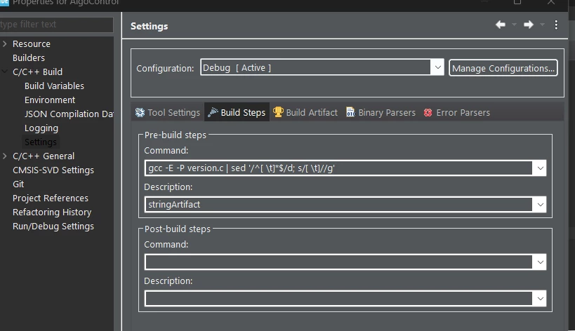

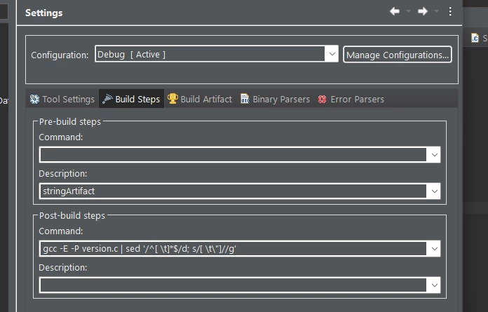

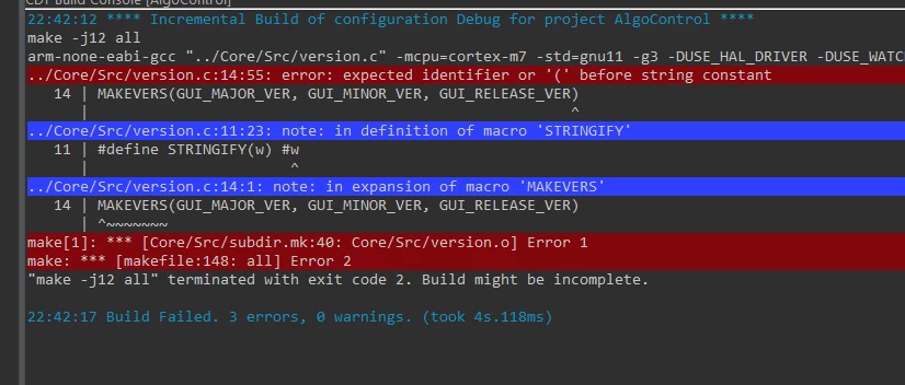

MPast.1
MPast.1Author
Senior
Mar 28, 2025 9:15 PM UTC

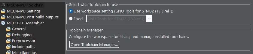

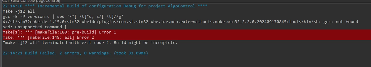

hi @Pavel A. ,
I create "version.c"
I inserted these in pre-build:
And I obtain an error:
But I'm in trouble with the compiler in use:
 trying to put on post-build command
I get this error:

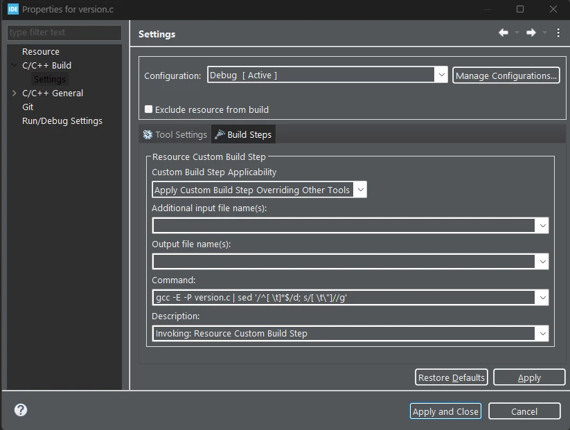

MPast.1
MPast.1Author
Senior
Mar 28, 2025 10:04 PM UTC
Hi @Pavel A. ,
 maybe I have done a little bit of confusion.
After reading for 100  times your original message, maybe I understood the right steps to do :
right click on "version.c" -> proprieties -->settings --> build Steps..
In this way everything is compiling without any error, but Output file has still the project name.
Pavel A.
Mar 28, 2025 10:08 PM UTC
Do not compile version.c with the application. It is not a correct C and cannot not compile to object file. Only preprocess. Better rename it to "version.h".
The "gcc" here should be the arm-none-eabi-gcc , the same compiler used for  STM32. The sed here is hidden in the "sh" so the whole command better should be wrapped in a script file, executed with "sh".  Unless there is other gcc and sed in the path (unlikely on Windows).

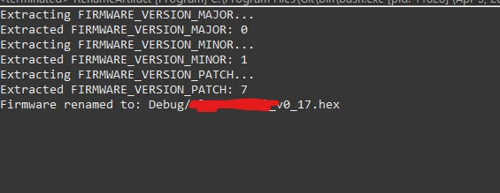

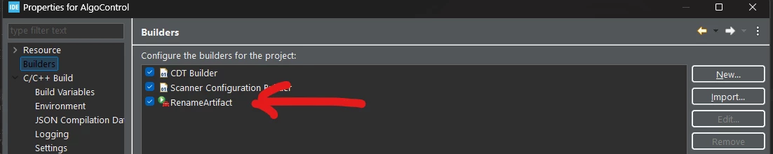

MPast.1AuthorBest answer
Senior
Apr 5, 2025 1:52 PM UTC
I found a solution.
#!/bin/bash
 exit 1
fi
else
 exit 1
fi
