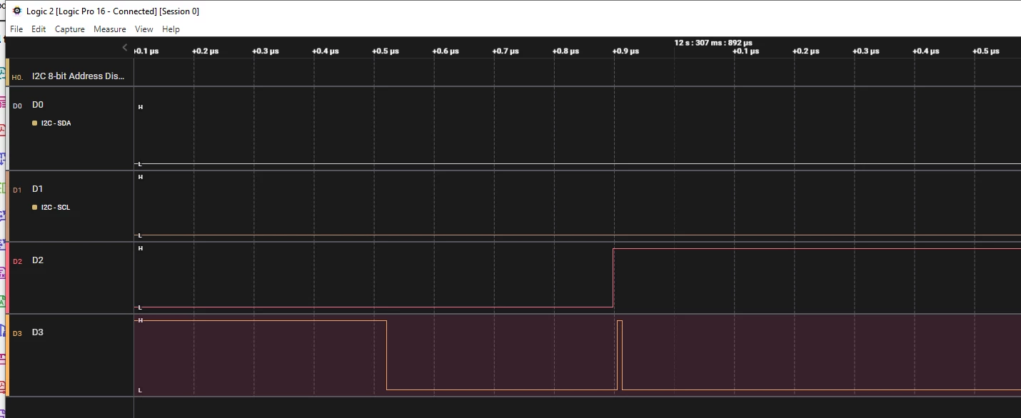

ARR update causing output glitch
Using STM32F765, I'm using tim1 with OC toggle.
The issue is glitches when I update the ARR value within the Repetition UP ISR.  ARR Preload is enabled, not sure what to look at here.
D2 toggles when the TIM1_UP_TIM10_IRQHandler fires, and D3 is TIM1 CH1 output, and the glitch seems obviously caused by the SetAutoReload when it fires.

>> .. the glitch seems obviously caused by the SetAutoReload when it fires.
Or you manually clearing the COUNTER
The general idea is that you set up the shadow registers ahead of time so they cleanly and consistently engage when the UPDATE event occurs, ie rolling into zero

The counter isn't being cleared.  yeah, its in the code there, but it turns off the timer completely, it only fires at the end.

I'd guess this is a measurement error.

I think this was indeed a measurement error.  I upped the sample rate and it seems to have gone away.
