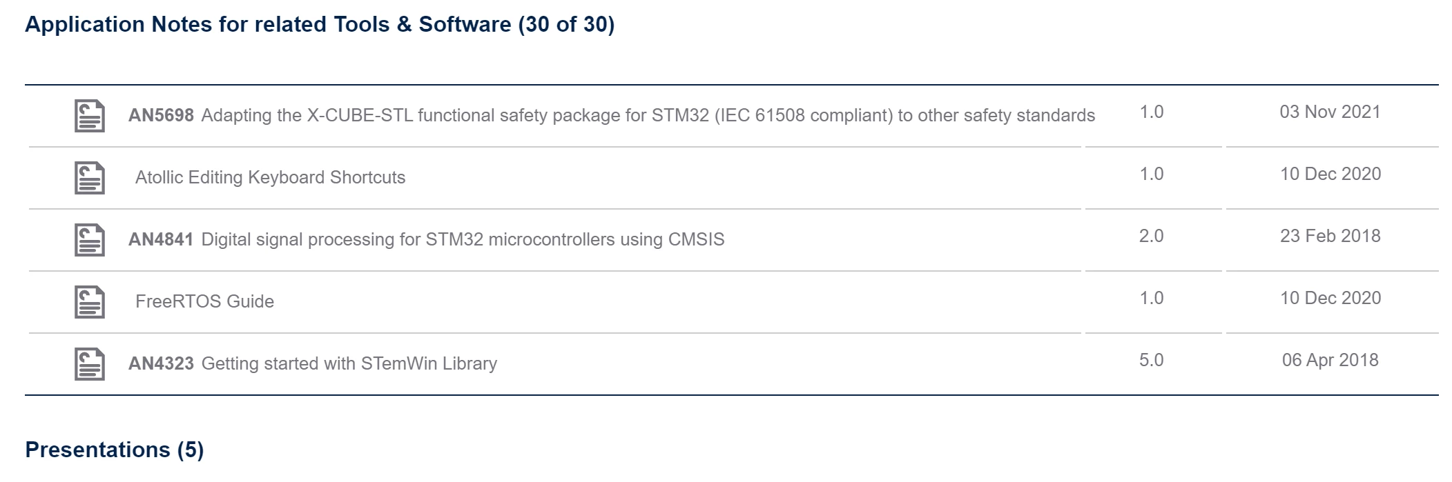

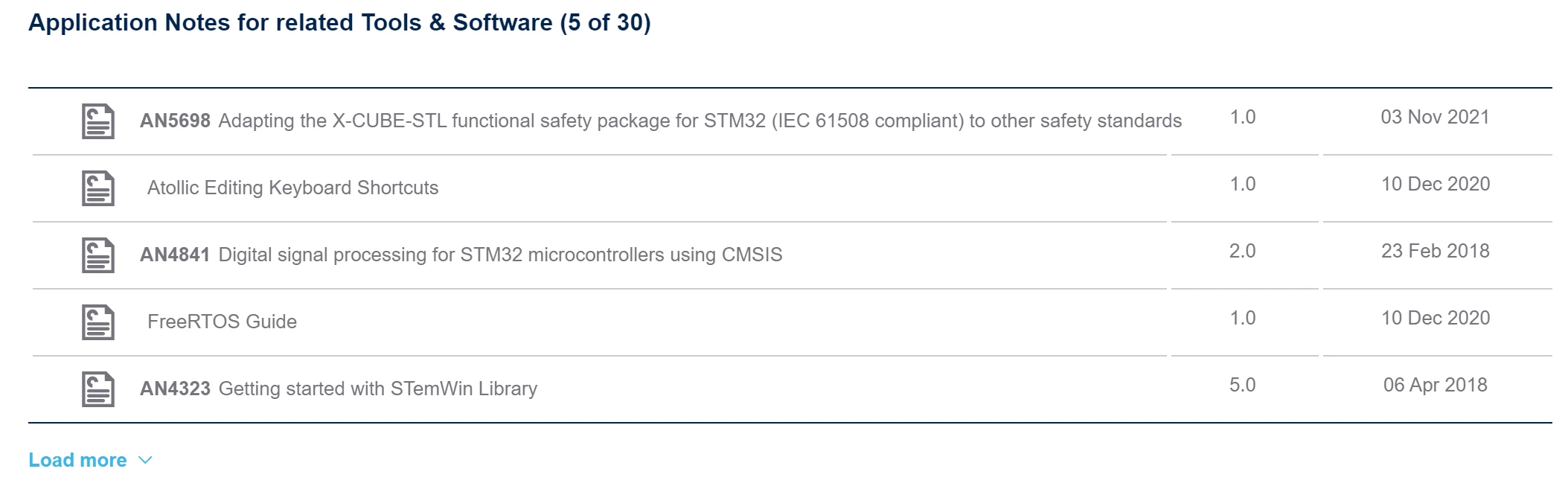

Peter BENSCH
January 6, 2022
Thanks, Jan,
Now it gets really mysterious, because I had definitely seen the AN4891 with my own eyes in this list yesterday - most strange.
Funnily enough, it shows up in the tab Tools & Software, under
MCU & MPU Embedded Software > X-CUBE-PERF-H7.
In X-CUBE-PERF-H7 it is then finally also to be found. Perhaps a little unfortunate positioned.
Regards
/Peter
@Community member​
January 6, 2022
It's under "Application Notes for related Tools & Software (30 of 30)".
However, depending on what buttons you click and how the website feels at the current moment, it may or may not be available with a "Load more" button.
