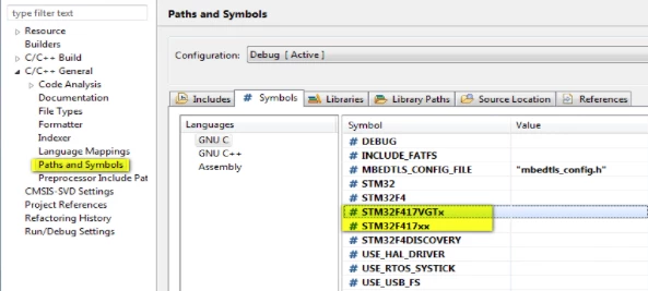

Nikita91
Lead II
April 4, 2022
Right click on the project name > Properties >C/C++ Build > Settings > MCU Compiler > Preprocessor
There is a define like "STM32F446xx". It allows to include the proper MCU file.
Also in C++ Proprocessor.
PHolt.1
PHolt.1Author
Senior
April 5, 2022
Thanks - also apparently here
