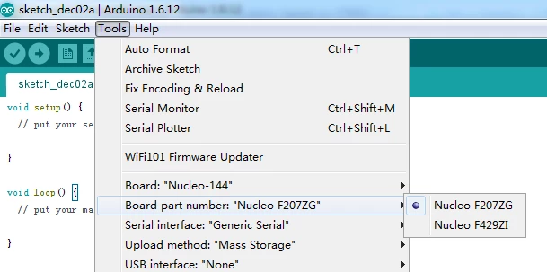

Hello guys
I want check the STM32F207ZG can run with arduino. But the
F207ZG is too big ,144 pins .
We plan to use F207VG  100pins,  it is can run complaint with arduino ?
Is there anything to change ?
#arduino-stm32f207*
Imen.DBest answer
Dec 5, 2017 2:40 PM UTC
Posted on December 05, 2017 at 15:40
Hello
zou.junhua
You can add new board following the instruction from wiki page :
https://github.com/stm32duino/wiki/wiki/Add-a-new-variant-%28board%29
Best Regards
Imen

waclawek.jan
Dec 2, 2017 1:55 PM UTC
Posted on December 02, 2017 at 14:55
Most probably yes.

junhua zou
Jan 3, 2018 9:51 AM UTC
Posted on January 03, 2018 at 09:51
Thanks very much ,
https://github.com/stm32duino/wiki/wiki/Getting-Started ♯ upload-method
I need to use the DFU Upload method, but I can not find it in ardunio Upload method ??
Jan 3, 2018 12:32 PM UTC
Posted on January 03, 2018 at 12:32
Hello
zou.junhua
The DFU upload method is not yet supported in arduino.
Best Regards
Imen
