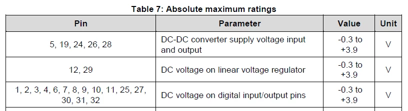

    Be careful about IO levels: if you are using Arduino UNO or similar board at 5V, you will need to use level shifters as the BlueNRG chip is not 5V tolerant:

    Thanks David. I am okay with the voltage values.
    I assume that the communication between X-NUCLEO-IDB04A1 and Arduino is SPI.  I actually want to know how to send data from Arduino to X-NUCLEO-IDB04A1.
