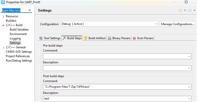

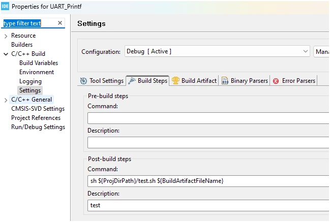

Pavel A.
September 23, 2024
What "doesn't work"? Any error message?
This works for me with CubeIDE 1.15.1:
And this:
