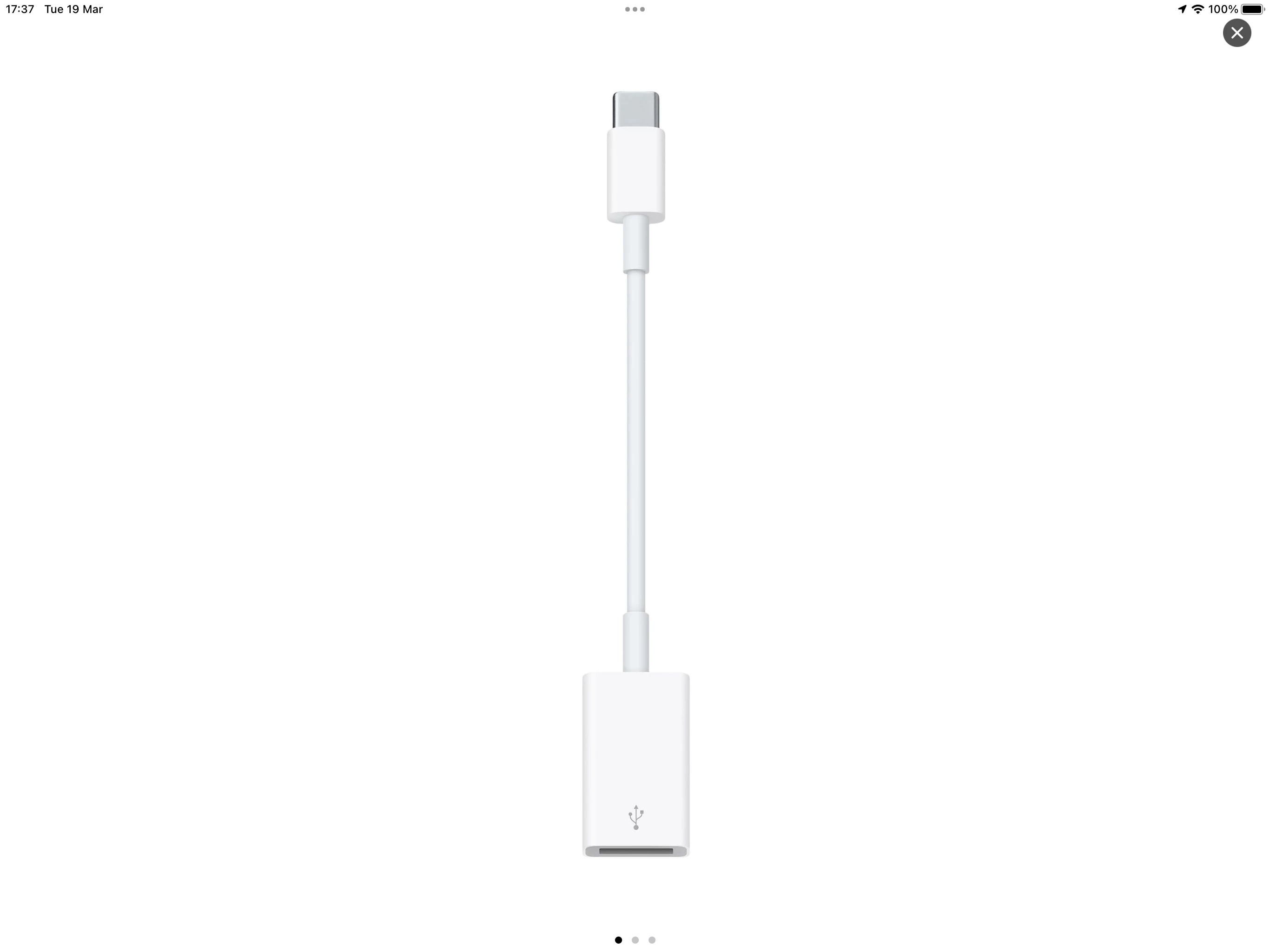

Hi @Amel NASRI
Yes, when I use a bus-powered USB hub in-between the Apple USB adapter and the STM32 NUCLEO board, the download works ok.

Hi @alw,
Does using the USB hub resolve the issue for you as suggested in the other discussion?
-Amel

Hi @Amel NASRI
