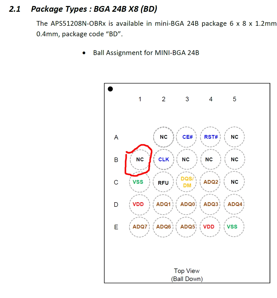

8. On one of my PCB revisions, the memory's B1 pin is accidentally tied to ground. Is this configuration acceptable, or will it prevent the memory from functioning correctly?
Are you asking about PB1?

I was referring to the B1 pin on the memory module itself. I have seen
APMemory employees here on the forum; perhaps they can provide some insight.
   => No issue
Alex

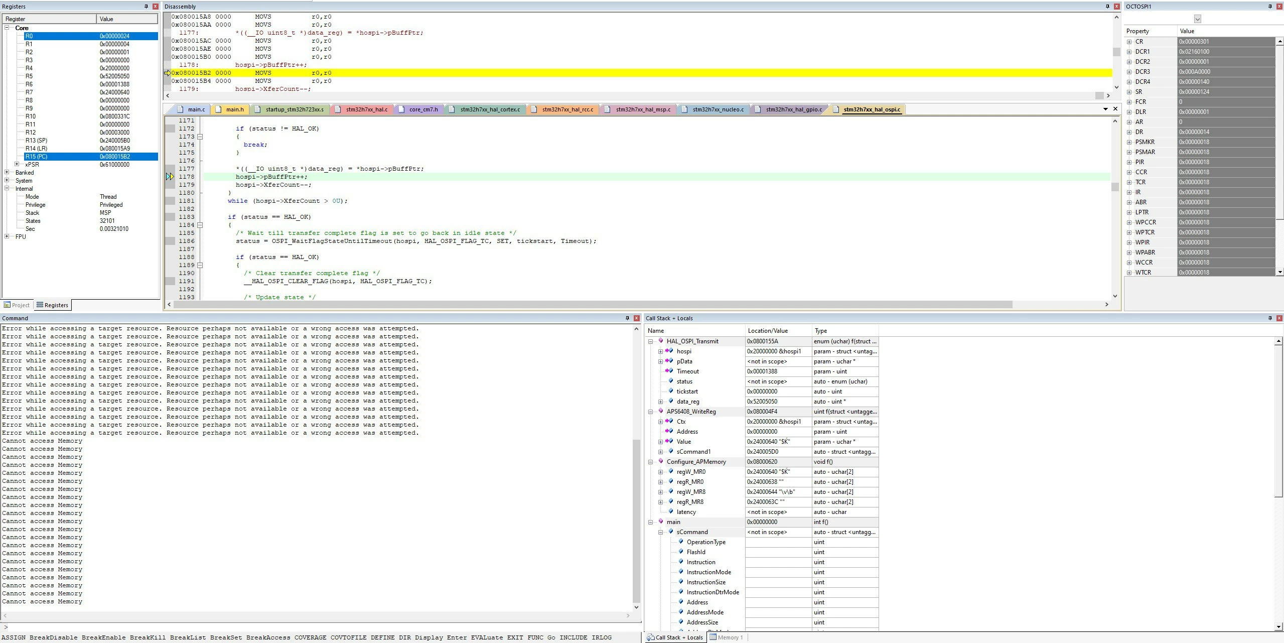

I have ported the code from the link for the H723 but encountered an error.
When calling the function HAL_OSPI_Receive(Ctx, Value, HAL_OSPI_TIMEOUT_DEFAULT_VALUE) , an error occurs in the file stm32h7xx_hal_ospi.c at the following lines:
  • *((__IO uint8_t *)data_reg) = *hospi->pBuffPtr;
  • hospi->pBuffPtr++;
I am also attaching the memory datasheet.
Thank you.
Tesla DeLorean
Guru
Aug 28, 2025 5:12 PM UTC
The disassembly doesn't look viable for sure. Not sure it the core has locked out access, or the pod is not connecting. So not sure stopping or stepping here is productive at this point.
I'd also caution on placing a peripheral watch view, as this tends to interfere with the operation of FIFO and stateful registers. Add some app side dumping or telemetry if possible.
You can inspect RAM based peripheral instance structures.
For Hard Fault situations.
https://github.com/cturvey/RandomNinjaChef/blob/main/KeilHardFault.c

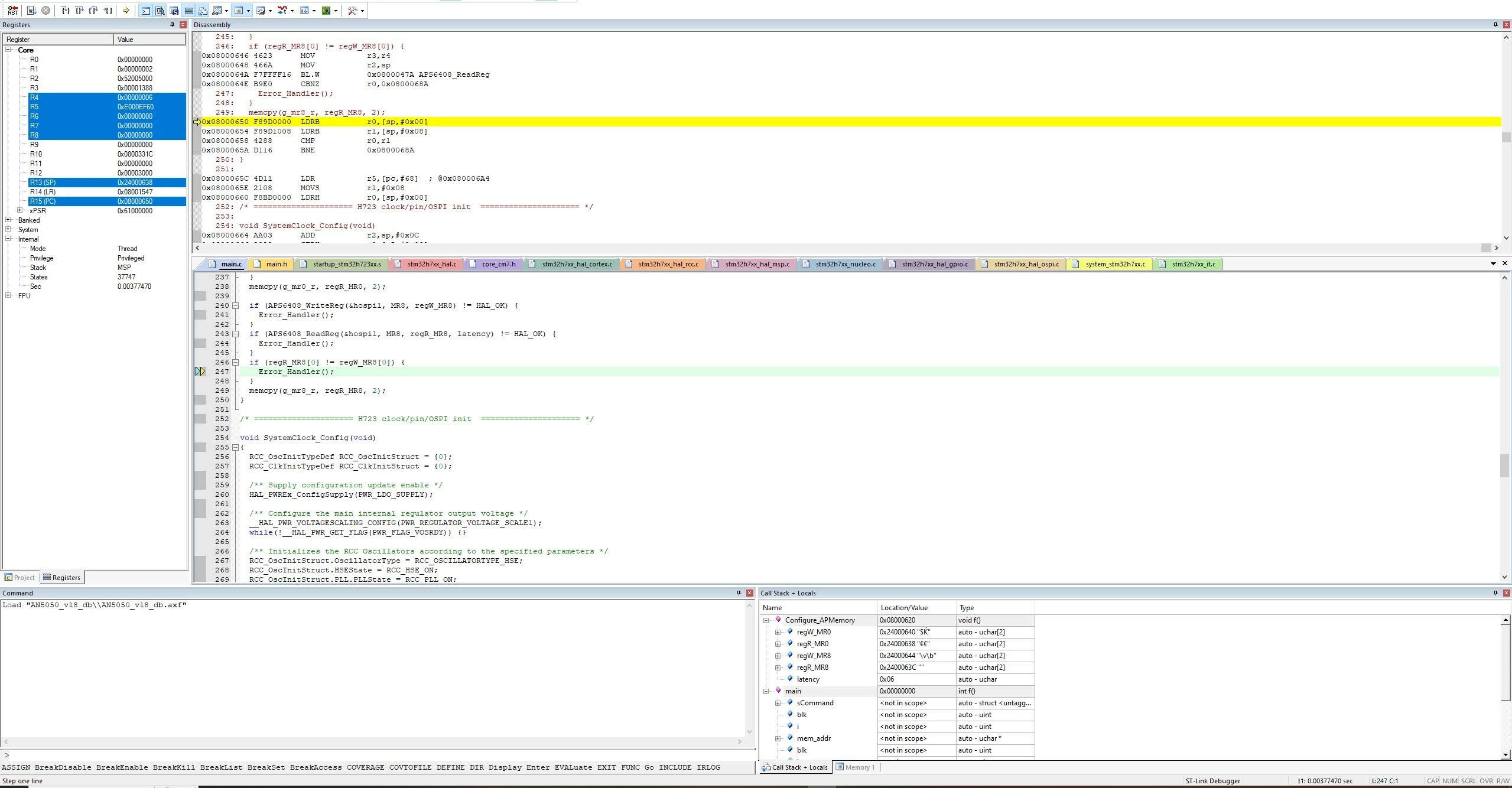

Maxim357Author
Sep 2, 2025 10:46 AM UTC
Thank you for your answer; it helped me make progress.
The code execution advanced further after I disabled the System Viewer window. However, it now gets stuck while comparing the values of the MR0 and MR8 registers.
Does this information from the debugger indicate a real issue, or could it just be a debugging artifact?
Furthermore, could displaying the MR register values in the Call Stack and Locals windows somehow be influencing their actual values?

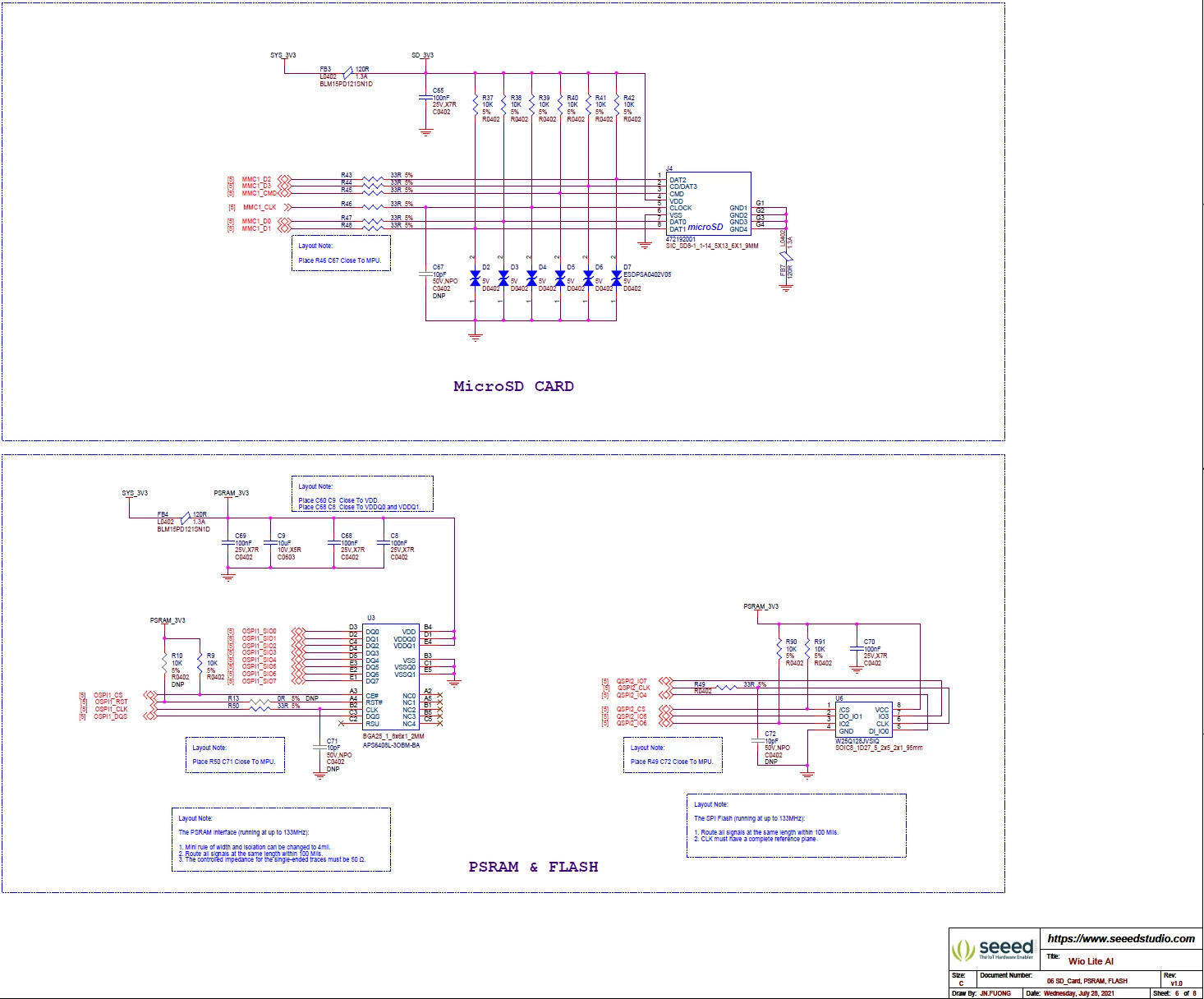

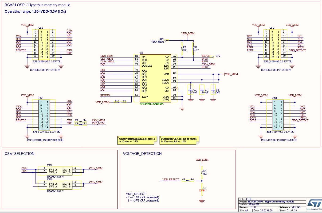

Sep 17, 2025 8:51 AM UTC
Good afternoon,
I have successfully established communication with the memory and performed a basic write-read test operation.
However, the Mode Register (MR) values still do not fully match the expected values, even though operations seem to be proceeding.
Could you please advise on the correct way to determine the proper MR values?
Furthermore, I purchased a Wio Lite AI board and realized there might be issues with my own board's design.
I have two reference designs: one from the MB1242 and another from the Wio Lite AI.
In both of these designs, the RESET pin is connected to VDD.
What is the purpose of this?
Is it necessary to add a series resistor and a capacitor to ground on the CLK line?
Doesn't this overcomplicate the design?
Should the Chip Enable (CE) pin be pulled up to the power supply via a resistor?
Is a 10μF capacitor in the power supply circuit a good idea?
Why are pins A2 and A5 connected to the power supply circuit in the MB1242 design?
Maxim

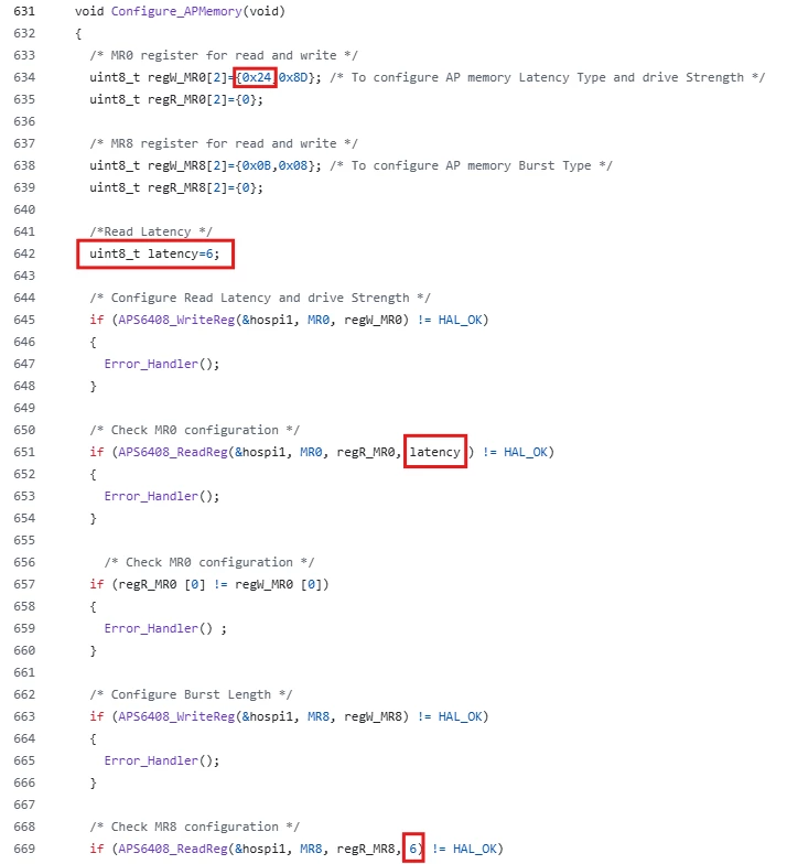

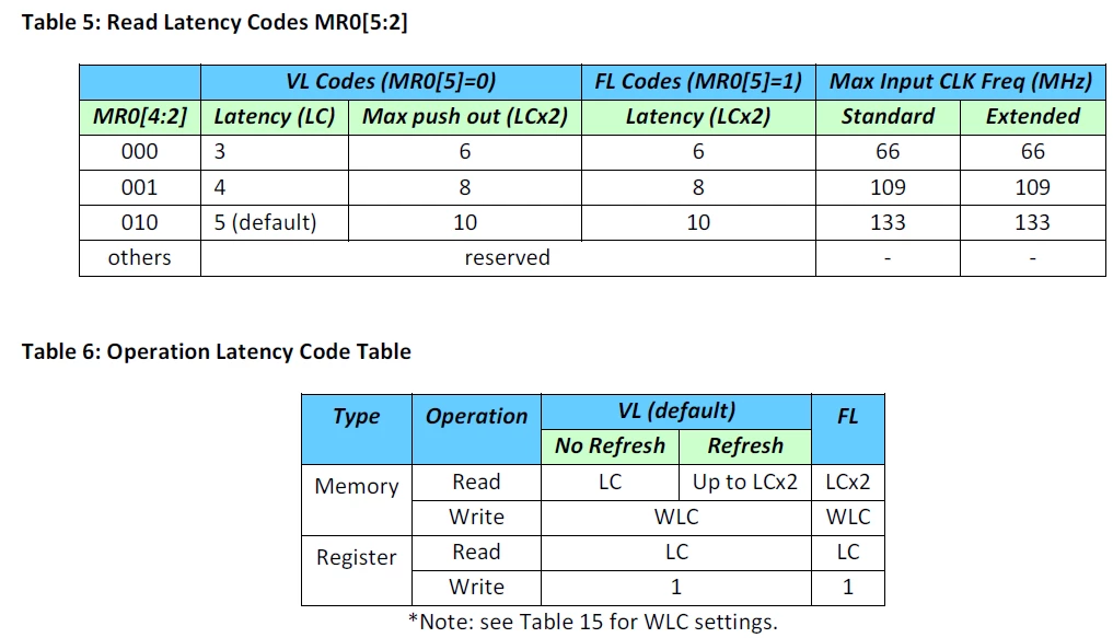

Mar 26, 2026 10:17 AM UTC
Hi @Maxim357 ,
Some suggestions for your reference:
1. Set the correct Read Latency when MR read (according to the clock frequency)
    For the sample code: Projects/STM32U575I-EV/Examples/OCTOSPI/OSPI_PSRAM_MemoryMapped/Src/main.c
     regW_MR0[0]==0x24 -> Read Latency Code (LC) = 4 (clock <= 109MHz)
     "uint8_t latency" should be set 4 if clock <= 109MHz
     Please use low speed clock (ex: 50MHz) to test first.
2. If possible, please upload your schematics for my review
3. If possible, please use Logic Analyzer to measure the MR read waveform. (This is the most accurate way to see the problem.)
