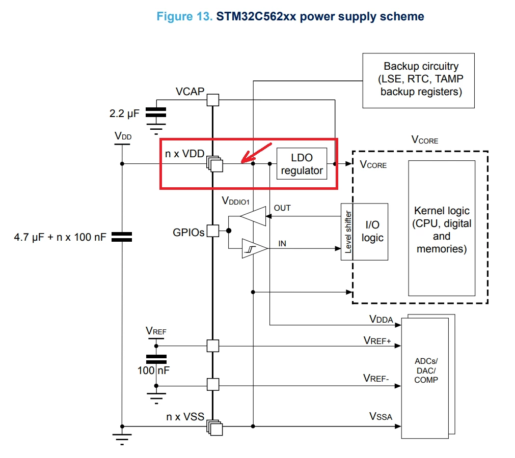

Any STM32C5 with dedicated input pin for the inner LDO?
Hi friends,
Does have processors from this family a dedicated input pin as the the input for inner LDO?
It will be in the future to supply the inner LDO with the voltage Vcc/2 from the splitter like LM2665 or other.

Hello ​@zbynoB and sorry for the late answer,
No STM32C5xxx has this feature. LDO input is internally tied to VDD. No external input for LDO:
From the datasheet:
1 reply
