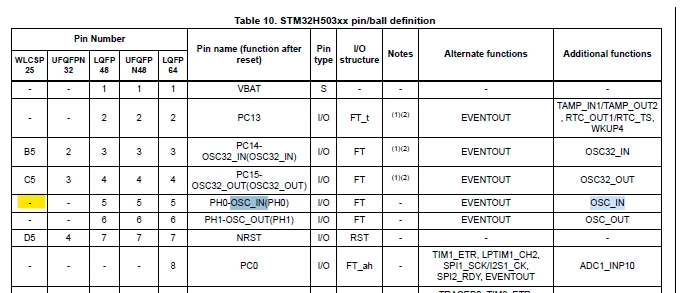

I’m working on a design where I need to communicate with two SPI devices that operate at different logic levels:
1) A sensor running at 1.8v logic (need SPI + 2 other lines, all at 1.8v)
2) Everything else on my board, preferably running at 3.3v, I will need CAN, UART, and another SPI.
I’m trying to avoid level shifters if possible (and avoid sourcing 1.8 V CAN/UART transceivers). Ideally, I’d like to use an STM32 that has split power domains, both with SPI peripherals.
So far, I’ve found that the STM32L496QI supports SPI on both the main VDD rail and the VDDIO2 rail (which can be independently run at 1.8 V), which fits the bill. The only issue is that it’s a 100-pin part, which is way more than I need for this design.

Best answer by Chris21
It looks like STM32H503 devices can meet these requirements, but only in the WLCSP25 package.
Chris21
July 18, 2025
Looking at this a bit more, although the WLCSP25 package allows for CAN on some pins, it does not appear to have any high-speed clock input pins, which you probably need for CAN...
sc123Author
July 18, 2025
Thanks for your help.
I'm kind of confused with your second reply, from what I can see in CubeMX, this chip supports FDCAN on pins PA11 & PB15, am I missing something?
Chris21
July 18, 2025
There's no OSC_IN pin for this package, CAN usually requires a precise and stable clock, better than what the internal clocks (HSI, CSI, LSI) can do.
