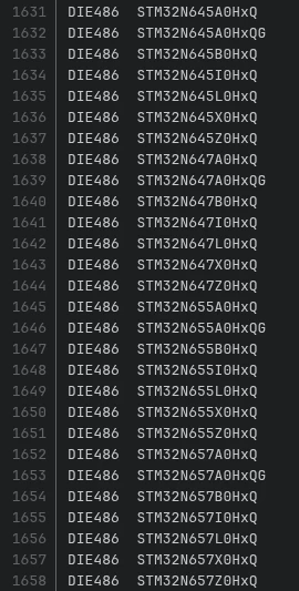

Any benefits for N6 without AI accelerator
I'm currently looking at something like this
  • STM32N657A0
But they sell a non AI accelerator version
  • STM32N655A0
Is there any benefits to using the non AI version of the chip.  Other then saving a few dollars on the chip?
No.
Anyway its same die, just NPU is disabled and its about 10% cheaper ...if in same package.

Senior
January 23, 2026
I know it was the same die.  I was just wondering if like some power rail or maby something else wouldn't be needed because it wasn't there.  Thanks for the info.
