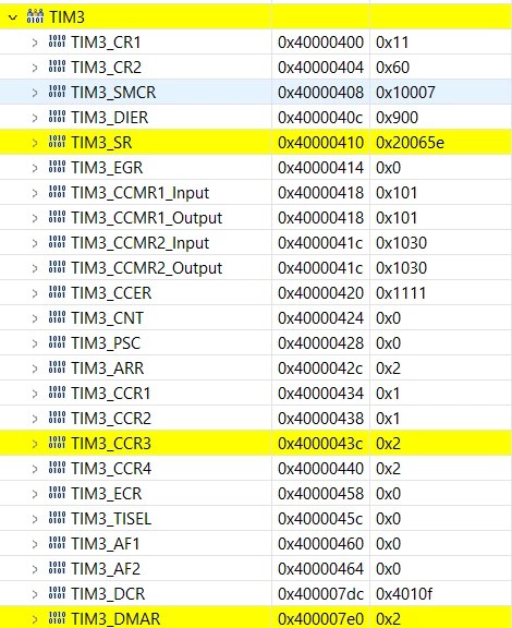

Can you share your timer channel configurations? Register values would be best.
LVan .31Author
July 31, 2024
Below are the register settings as shown in STM32CubeIDE
Also I use DMA to constantly change the value of CCR3 which is what the DMA Burst statement below is for.
The timer starts at 0, when the rising edge is detected the count goes to 1 which matches CCR3 and the output is toggled. Also the DMA is triggered to set CCR3 to 0. Now on the next falling edge the count goes to zero which matches the new value of CCR3 and the output is toggled again and so on.
