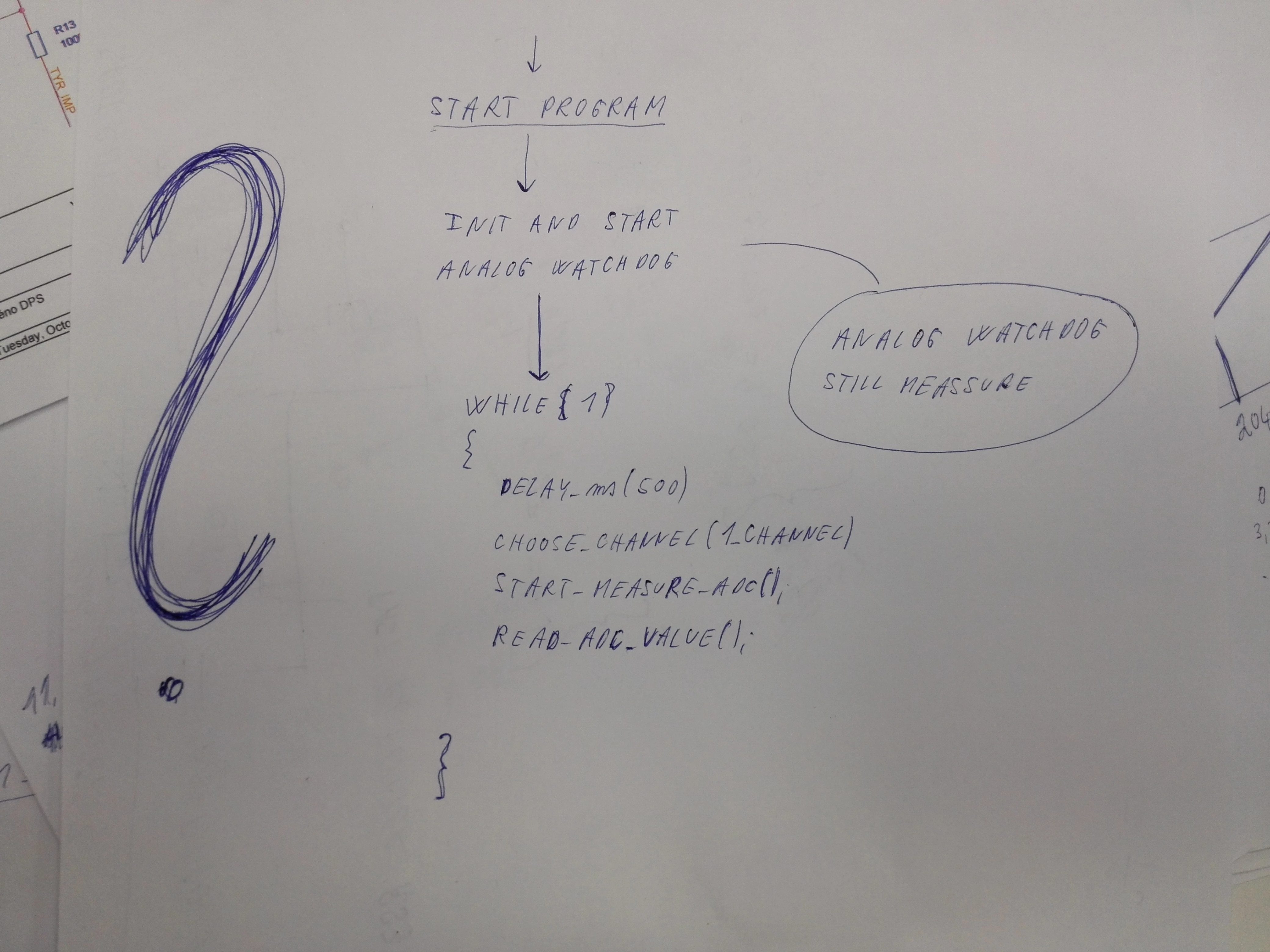

Hi Guys,
I have STM32L071 and I want to use analog window watchdog for detecting if voltage on channel 2 is bellow my threshold. I use it and it works really nice.
I use this settings for ADC:
/**Configure the global features of the ADC (Clock, Resolution, Data Alignment and number of conversion)
hadc.Instance = ADC1;
hadc.Init.OversamplingMode = DISABLE;
hadc.Init.ClockPrescaler = ADC_CLOCK_SYNC_PCLK_DIV2;
hadc.Init.Resolution = ADC_RESOLUTION_12B;
hadc.Init.SamplingTime = ADC_SAMPLETIME_39CYCLES_5;
hadc.Init.ScanConvMode = ADC_SCAN_DIRECTION_FORWARD;
hadc.Init.DataAlign = ADC_DATAALIGN_RIGHT;
hadc.Init.ContinuousConvMode = ENABLE;
hadc.Init.DiscontinuousConvMode = DISABLE;
hadc.Init.ExternalTrigConvEdge = ADC_EXTERNALTRIGCONVEDGE_NONE;
hadc.Init.ExternalTrigConv = ADC_SOFTWARE_START;
hadc.Init.DMAContinuousRequests = ENABLE;
hadc.Init.EOCSelection = ADC_EOC_SINGLE_CONV;
hadc.Init.Overrun = ADC_OVR_DATA_OVERWRITTEN;
hadc.Init.LowPowerAutoWait = DISABLE;
hadc.Init.LowPowerFrequencyMode = DISABLE;
hadc.Init.LowPowerAutoPowerOff = DISABLE;
if (HAL_ADC_Init(&hadc) != HAL_OK)
_Error_Handler(__FILE__, __LINE__);
/**Configure the analog watchdog
AnalogWDGConfig.WatchdogMode = ADC_ANALOGWATCHDOG_SINGLE_REG;
AnalogWDGConfig.Channel = ADC_CHANNEL_2;
AnalogWDGConfig.ITMode = ENABLE;
AnalogWDGConfig.HighThreshold = 4095;
AnalogWDGConfig.LowThreshold = 2808;
if (HAL_ADC_AnalogWDGConfig(&hadc, &AnalogWDGConfig) != HAL_OK)
And whenever the voltage is bellow the level threshold onchannel 2 so interrupt occurs.
But now I want to use also classical measuring on channel 1.
I want to the analog watchdog works still independenty on CPU performance. And in some time I want to read voltage on channel 1.  But it does not work with nalog watchdog. How to combine this 2 methods?

The 'old' SPL used to come with simple ADC examples that configured one ADC channel in conjunction with DMA, without any interrupt (neither ADC nor DMA).
This examples just came by to read the conversion resultss occasionally from the DMA target address.
I don't have a L071, not sure if the method would interfere with the watchdog interrupt.
Alternatively, you can use a second ADC channel, externally connecting them.
John Craven
Senior
October 5, 2017
Posted on October 05, 2017 at 17:44
I start using the AWD to detect peaks. The AWD interrupt fires continuously while the peak exists and you are sampling. Its the way it is.
