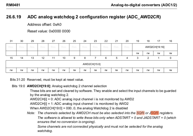

In the reference manual, RM0481 rev1, for analog watchdog window it mentions SQRi and JSQRi registers. I can not find any descriptions about these registers.
Can someone help me clarifying this?

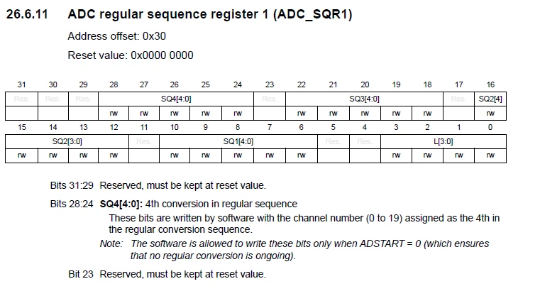

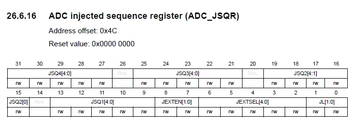

Hello @Imre
You can find details about those two registers on the section 26.4.11 "Channel selection (SQRx, JSQRx)" and pages from 1128 to 1134 of the RM0481
PS: use the last revision (Rev2).
Best Regards.

mƎALLEm
Apr 10, 2024 2:24 PM UTC
Starting from page 1128:
SQRi:
JSQR:
Meawhile, I think it woul be better to rename them with the corresponding naming used in the documentation starting by "ADC_"
For JSQR, there is only one regiter so no need to add "i" at the end.
I'm escalating this internally to confirm and get back to you with a feedback
