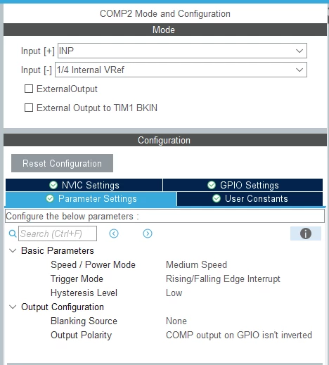

I am working with an STM32G071. I am using Comp2. I have configured it with the STM32CubeIDE. Presently, It is set to "medium" speed/power, and Rising Edge Input with High Hysteresis. The positive input is set to INP/PB6. The negative input is set to Internal VRef. (I can't find anywhere in the manual what that value is. Maybe its only in the data sheet!?) Anyway, my problem is when I enable the AC it instantly triggers the interrupt. However, I don't see any evidence that VALUE is ever high. Meaning It doesn't look like the comparator is actually triggered but maybe its some type of configuration initialization issue? If I ignore this first trigger the AC seems to work fine afterwards.
I have checked the flags in EXTI and they are not set until the exact moment the AC is enabled.
Any idea what could be causing this? I haven't found anything on the forums that might point to an explanation.

I have also used
hcomp2.Init.InputMinus = COMP_INPUT_MINUS_3_4VREFINT;
As well as using DAC1 output as the COMP negative input. Still same behavior. Initial false trigger then normal operation.

KnarfB
January 20, 2025
Interesting. Don't have a G071 board here, but used my Nucleo-L432KC. Connected INP firmly to GND and used vrefint/4 for INM.
Same effect here: initial interrupt is fired.
Stepping though the generated code, I see that
MX_COMP2_Init does the initialization, including setting COMP2 CSR and clearing and preparing the EXTI line.
But, MX_COMP2_Init does not yet enable COMP2.
When HAL_COMP_Start enables COMP2 this (somehow) immediately triggers that interrupt.
Have copied the CSR initialization plus COMP2 enable into few lines of code which I have put into an early user code block:
 /* USER CODE BEGIN SysInit */
 RCC->APB2ENR |= RCC_APB2ENR_SYSCFGEN;
 (void)RCC->APB2ENR; // Delay after an RCC peripheral clock enabling
 COMP2->CSR = 0x00c10104; // value copied from HAL_COMP_Init
 COMP2->CSR |= COMP_CSR_EN; // enable COMP2
 /* USER CODE END SysInit */
Now, COMP2 is enabled well before the EXTI and NVIC stuff is initialised, and there is no more initial interrupt.

Carl_GAuthor
Senior II
January 21, 2025
Yes, I tied the pin directly to GND, and the COMP output monitored with an oscilloscope.
I have added a post as a bug report here
https://community.st.com/t5/stm32-mcus-products/comparator-bug-report-on-stm32g0/td-p/763733
I think your solution would work. My alternate was to disable the interrupt just before I enable COMP.  Then reenable it afterward. This is because I enable and disable COMP based on the operating state of my module.
Its the COMP itself that is sending a trigger to EXTI.
