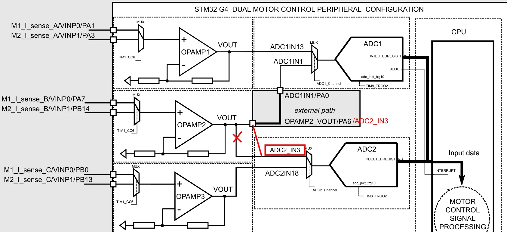

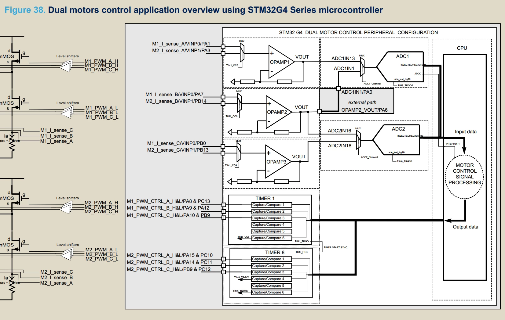

在本文的第 32 页,图 38 显示了双电机控制应用的概述。
其中 OPAMP2 通过内部多路复用器连接到 ADC2IN16,
它还输出到外部引脚 PA6,该引脚通过附加线路连接到 ADC1IN1/PA0。

"On page 32 of this article, Figure 38 shows an overview of a dual motor control application.
Where OPAMP2 is connected to ADC2IN16 via an internal multiplexer,
it also outputs to external pin PA6, which is connected to ADC1IN1/PA0 via additional lines."

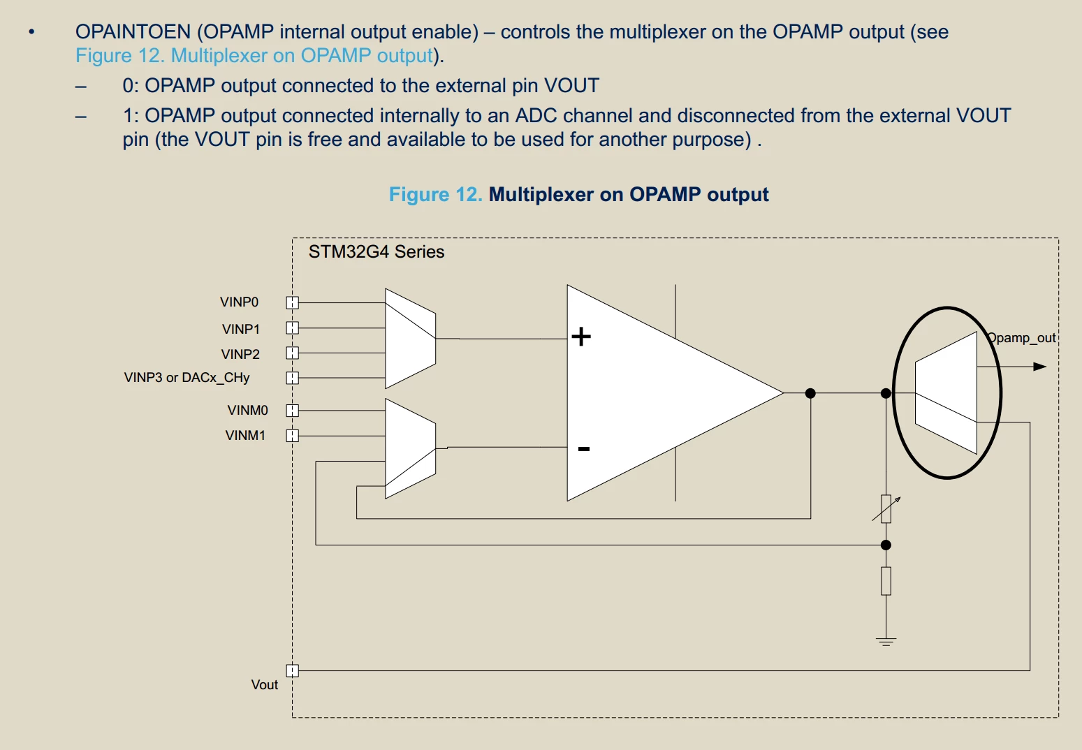

第 10 页的图 12 描述了多路复用器的功能,
它不能同时向 ADC 和外部引脚输出信号。

  There is a mistake in the Figure 38. The input to ADC2 must be taken from PA6 pin and not from the internal OPAMP2 output.
Correct schematic is like this:

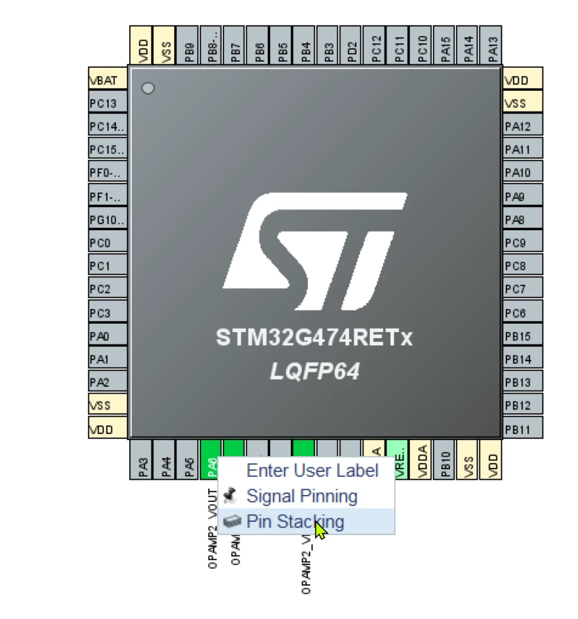

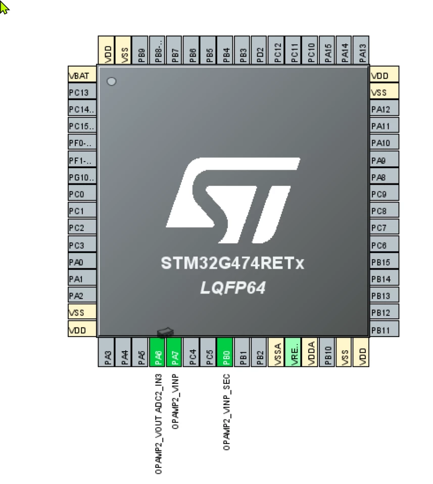

In CubeMX : it is possible to configure this correction like described above - but you must enable "Pin Stacking" on the PA6 pin (right clock on PA6 pin) - to be able to connect multiple functions on PA6 (ADC2_IN3 + OPAMP2_VOUT):
