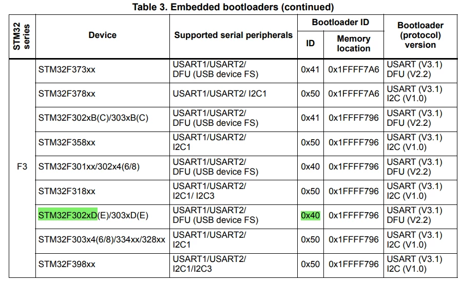

October 12, 2023
Hello @MButsch
Thank you for your feedback.
Indeed, the product bootloader version refers to the version of the bootloader software that is installed on the product, while the bootloader USB protocol version refers to the version of the USB protocol that is used by the bootloader. You can check the bootloader version by referring to Bootloader ID memory location provided in Table 3. Embedded bootloaders.
