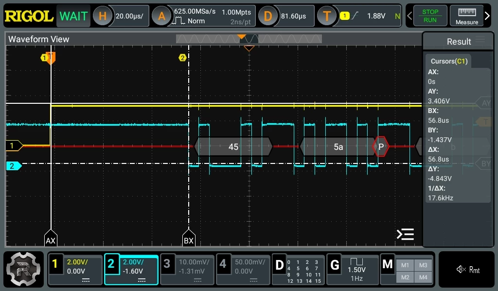

HCLK: 210MHz
TIM1: PSC=20 (10 MHz), ARR=9999, SMCR.SMS=100 (Slave Reset), SMCR.TS=ETRF, CR1.URS=1, CR2.MMS=0000 (Reset), MSM=1, TIM1_ETR connected to GPS 1PPS.
TIM2: PSC=0, ARR=210021000, SMCR.SMS=100 (Slave Reset), SMCR.TS=0 (TIM1_TRGO), CR2.MMS=0000 (Reset), MSM=1.
DMA CH triggered by TIM2_TRGO sends datagram over USART every second.
Observation: The falling edge of the first start bit on the USART TX broadcast is delayed by several microseconds relative to the rising edge of the 1PPS signal (used to trigger the DMA transfer and timer reset).
CH1 is 1PPS from GPS
CH2 is USART TX pin
Delay is 56us

This is a too long chain to draw conclusions. Set up TIM1 and TIM2 to output PWM and add to your observation. I also don't see how would it result in 56us delay, wouldn't DMA and UART be involved.

Hi
One thing is documentation itself. To me it shall be improved.
Other thing is 56us delay which I can not explain.

I'm not sure what exactly do you want to achieve - maybe drawing a timing diagram highlighting the expected events in the timers at various starting conditions would help - but I would doubt the DMA-UART mechanism at the first place. You may want to start by characterizing this, e.g. by outputting a PWM waveform from a free-running timer, which simultaneously triggers the DMA-UART mechanism. Divide et impera.
And, as I've said, if you want to draw conclusions from the timers' setup, output PWM from the timers in order to visualize their state. This may be easier to do using something like a Nucleo (and perhaps a pulse generator instead of the GPS, to be able to simulate various mutual speed relationships), rather than some dedicated hardware.
