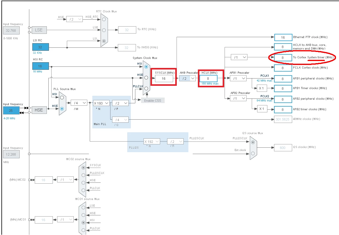

Would depend if SYSCLK is actually 16 MHz, where there are 16,000,000 cycles per second, and each is 1/16,000,000 seconds in duration.
The SysTick typically clocks at HCLK or HCLK/8, and the down count is 24-bits wide

I found SYSCLK and HCLK.
0693W00000NqnypQAB.pngWhich of these two parameters determines how long one tick will last?

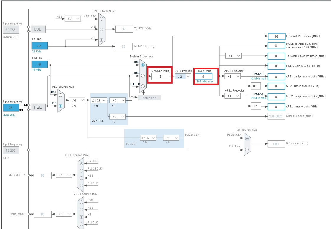

waclawek.jan
May 28, 2022
0693W00000Nqnz4QAB.pngJW

May 28, 2022
I checked with this code what frequency SysTick uses as a reference for the duration of one tick.
#include "main.h"
uint16_t delay_count=0;
void SysTick_Handler(void)
 if(delay_count>0)
 delay_count--;
void delay_ms(uint16_t delay_temp)
 delay_count=delay_temp;
 while(delay_count)
int main(void)
RCC->AHB1ENR|=RCC_AHB1ENR_GPIODEN;
GPIOD->MODER|=1<<(2*12);
SysTick_Config(16000000);
 while (1)
 GPIOD->ODR^=(1<<12);
 delay_ms(5);
 delay_ms(5);
The SYSCLK frequency is used as a reference for the duration of one tick.
That is, 1 tick is equal in my case to 1/16,000,000=62.5 ns
Probably the System Timer that you showed is also used somehow, I don't know how.

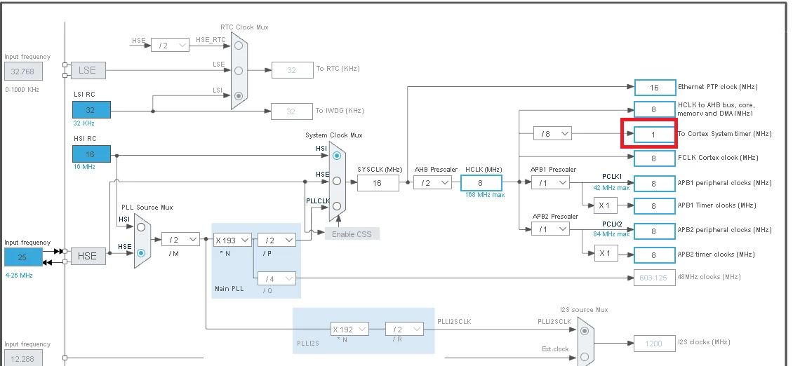

MMust.5
MMust.5Author
Senior
May 29, 2022
If I change the System Timer to 1 MHz, then the duration of the blinking of the LED does not change, which means that the System Timer most likely does not control the duration of one tick.
However, changing SYSCLK also does not change the blinking duration of the LED.
waclawek.jan
May 29, 2022
By clicking in CubeMX and using generated code, you should accept that CubeMX "does things".
If you want to understand them, look into those. In other words, read the CubeMX-generated and Cube-provided sources and act accordingly. They are open-source.
Ultimately, the mcu works out of the content of its registers, so if you want to really understand what's going on, read out those registers.
Pavel A.
May 29, 2022
@Community member​
Cube does not generate code for the divisor of SysTick, at least for one STM32 type.
So if you change it from 1 to 8 and re-generate it may not work.
