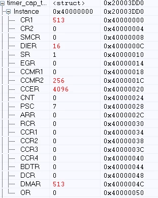

Hi everyone.
I'm trying to setup TIM2_CH4 remapped as input capture, in order to detect rising edges on PB11.
I'm working with HALs. And my code is next:

Why I am not having any interrupt? My registers value after set_callback function is next:
Which seems to be OK. So, what's the matter? Why I'm not getting any interrupt?
I'm using STM32105VC microcontroller.
Thank you in advance!
