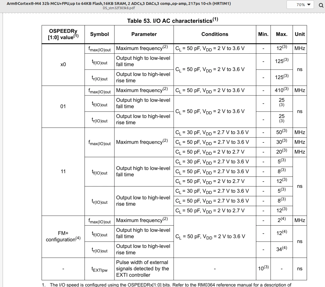

Check the datasheet / reference manual, but all GPIOs have configurable glitch filters implemented.
Here an example I had at hand, for another MCU :
GPIO speed and glitch filter settings are not neccessarily related to the core clock frequency.

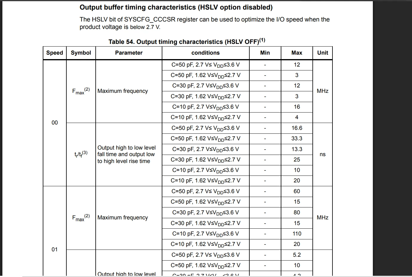

I could only find this in the datasheet
What about the timer input capture, is it same like GPIO EXT Interrupt.
I even applied a 1MHz signal still not working, but for 100KHz it is working, but i need it to work for fast signals.
