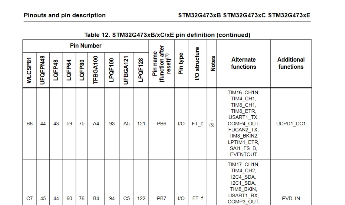

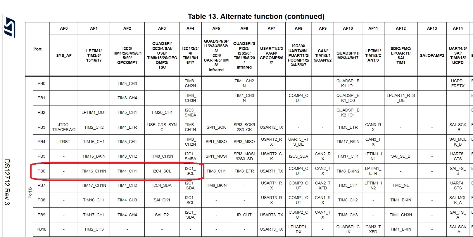

I'm using the STM32G473VCT6 and I'm confusing with alternate functions available in pin PB6. According to table 13 in datasheet it is possible to configure this pin as I2C1_SCL, but in table 12 this option doesn't exist. What is the correct option?

Table 13 tends to be more definitive

I2C4_SCL is missing, too.
Imen GH
May 7, 2021
The Table 12 is the correct one.
Thank you for reporting this typo. We will correct this in the next release.
