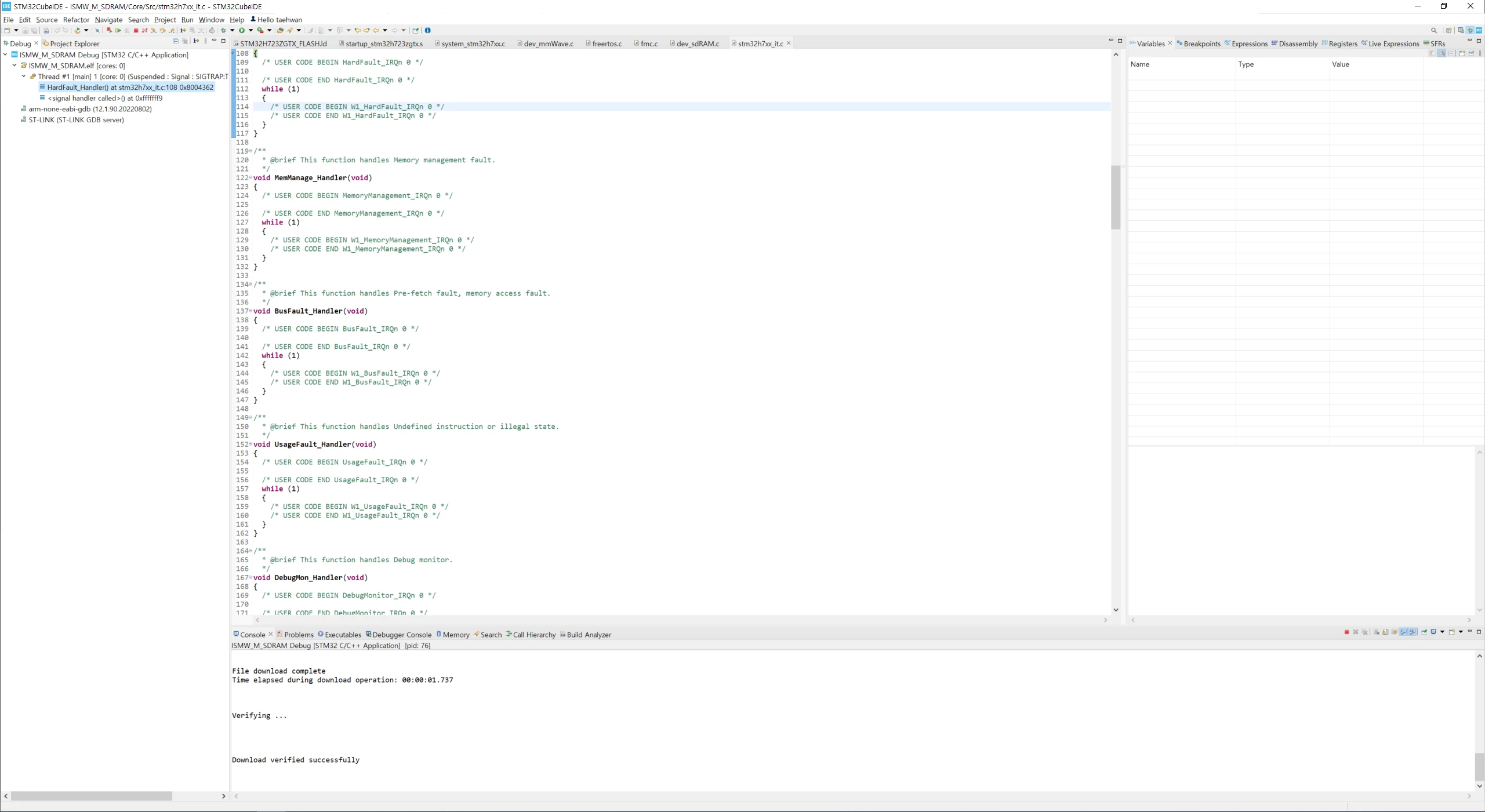

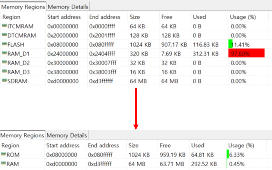

All internal RAM has been used to implement the current application.
Additional feature implementation requests require variable allocation and access to external RAM.
I reviewed the STM32CubeH7 example and applied it to my project, but encountered a HardFault Handler.
(Modify STM32H747XIHX_FLASH.ld file in my Project)
Please let me know if there is anything else I need to check.

Build Analyzer - Memory Regions
HardFault_Handler
Debug Message

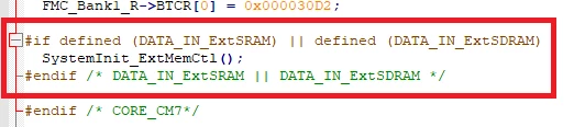

You need to initialize the memory first (GPIO and FMC) in SystemInit() / system_stm32h7xx.c.
If you look at system_stm32h7xx.c provided in one of the STM32H747I-EVAL examples you can find the following:
So look at SystemInit_ExtMemCtl() implementation. You need to activate de definition DATA_IN_ExtSDRAM.

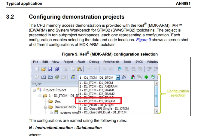

Also there is an example how to locate the global variables in the external SDRAM in x-cube-perf-h7  related to the AN4891 STM32H72x, STM32H73x, and single-core STM32H74x/75x
system architecture and performance
Look at the project config 6 where the code is executed in ITCM and all variables are located in SDRAM:
