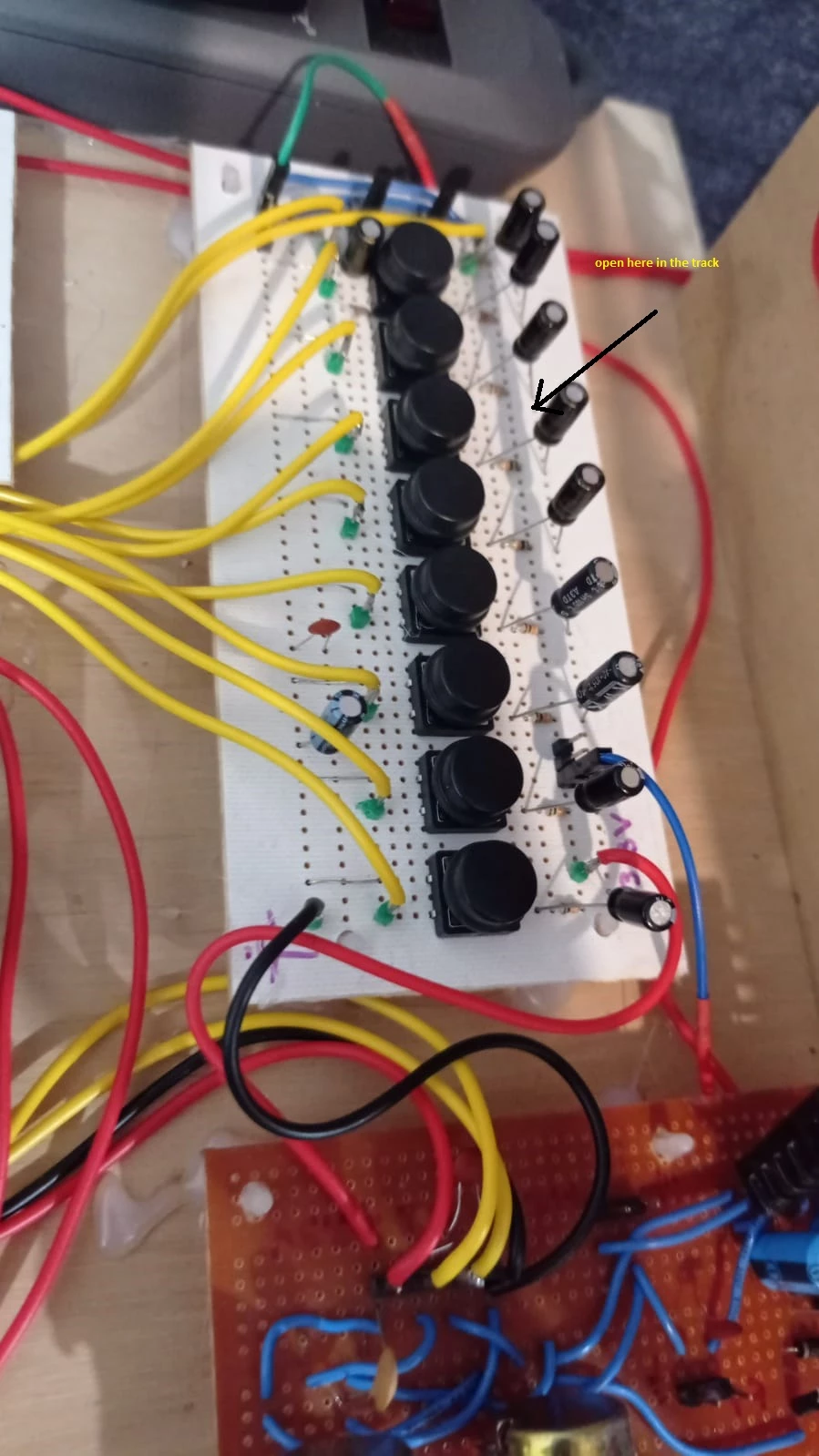

Thank you for your ideas, I got a new path because of you to look for and I found when I press a button it's created an spike that triggers to all inputs EXTIs, I'll look for a mistake or something in the hardware. I got an oscilloscope to do this, I need to buy one.
Post relevant portion of schematics, and a photo of your setup.
October 6, 2023
Hi, I found a broken track in my pcb, it looked fine when I tested with a multimeter for continuity but when I pressed a button the force applied opened the track and isolated the ground connection of my debounce capacitors giving an spike in almost all inputs

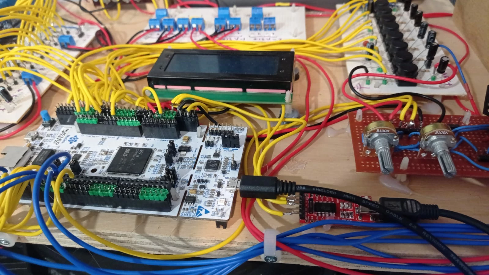

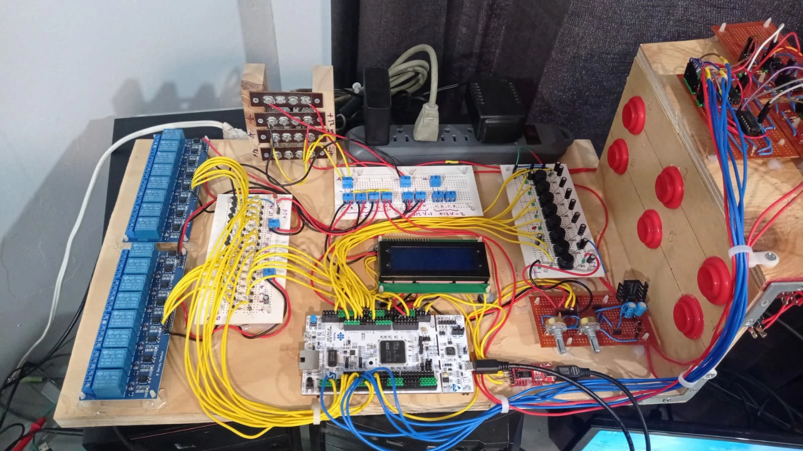

this is my project!!
October 6, 2023
