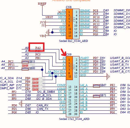

I don’t know.
Did you test the example I shared as it is or not?
Do you confirm you are using STM32H723 NUCLEO board? PA3 is on CN9/pin 1:
It's working from my side.

yes, i use your switch case, and its working! thanks. But PA3 still not...
MM..1
November 16, 2024
Primary check with scope PA3 states, and secondary only one EXTI3 can be used. Check dont code other GPIOX3?
