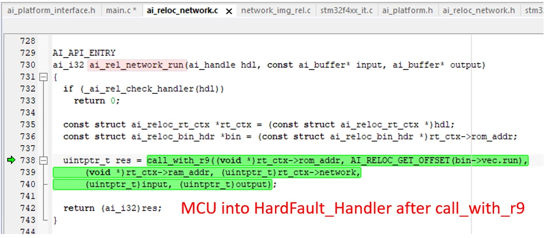

I'm testing running a relocatable binary model.
But when I use ai_rel_network_run(), I get into HardFault.
The detailed error information is as follows, with my current test code attached.
Hope that someone can help to resolve this issue!
Thanks.

AI_Run()
static void AI_Run(float *pIn, float *pOut)
 ai_i32 batch;
 ai_error err;
 ai_buffer *ai_input = net_info.inputs;
 ai_buffer *ai_output = net_info.outputs;
 ai_input[0].data = AI_HANDLE_PTR(pIn);
 ai_output[0].data = AI_HANDLE_PTR(pOut);
 batch = ai_rel_network_run(net, ai_input, ai_output);
 if (batch != 1) {
 err = ai_rel_network_get_error(net);
1 reply

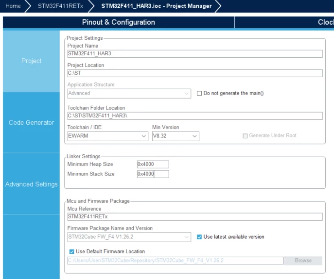

0693W00000SwKyEQAV.pngI had already increased both heap and stack size.
