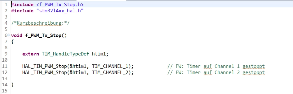

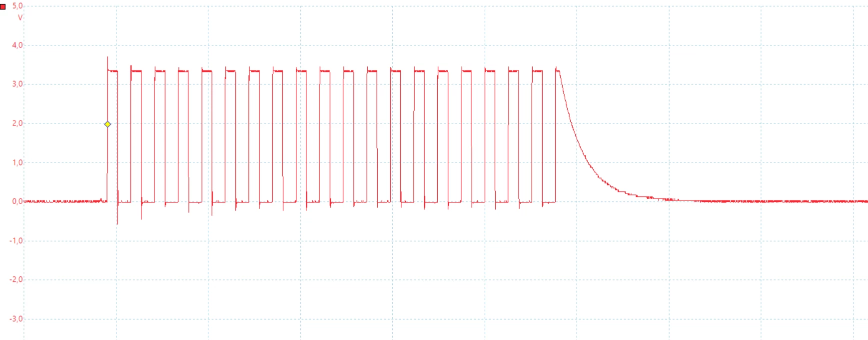

After stopping a PWM Output (HAL_TIM_PWM_Stop) the signal is slowly decreasing instead of switching instantly to low (0 Volt).

    That function probably disables the PWM through clearing TIMx_CCER.CCyE, which threestates the output.
    Change mode from PWM to one of the Forced in repective TIMx_CCMRz.OCyM.

    I know that if you put duty = 0 with the HAL function, the stop is immediate. I haven't tried any other method at all. It seems waclwek.jan is right and the output remains in three-state for a while.
