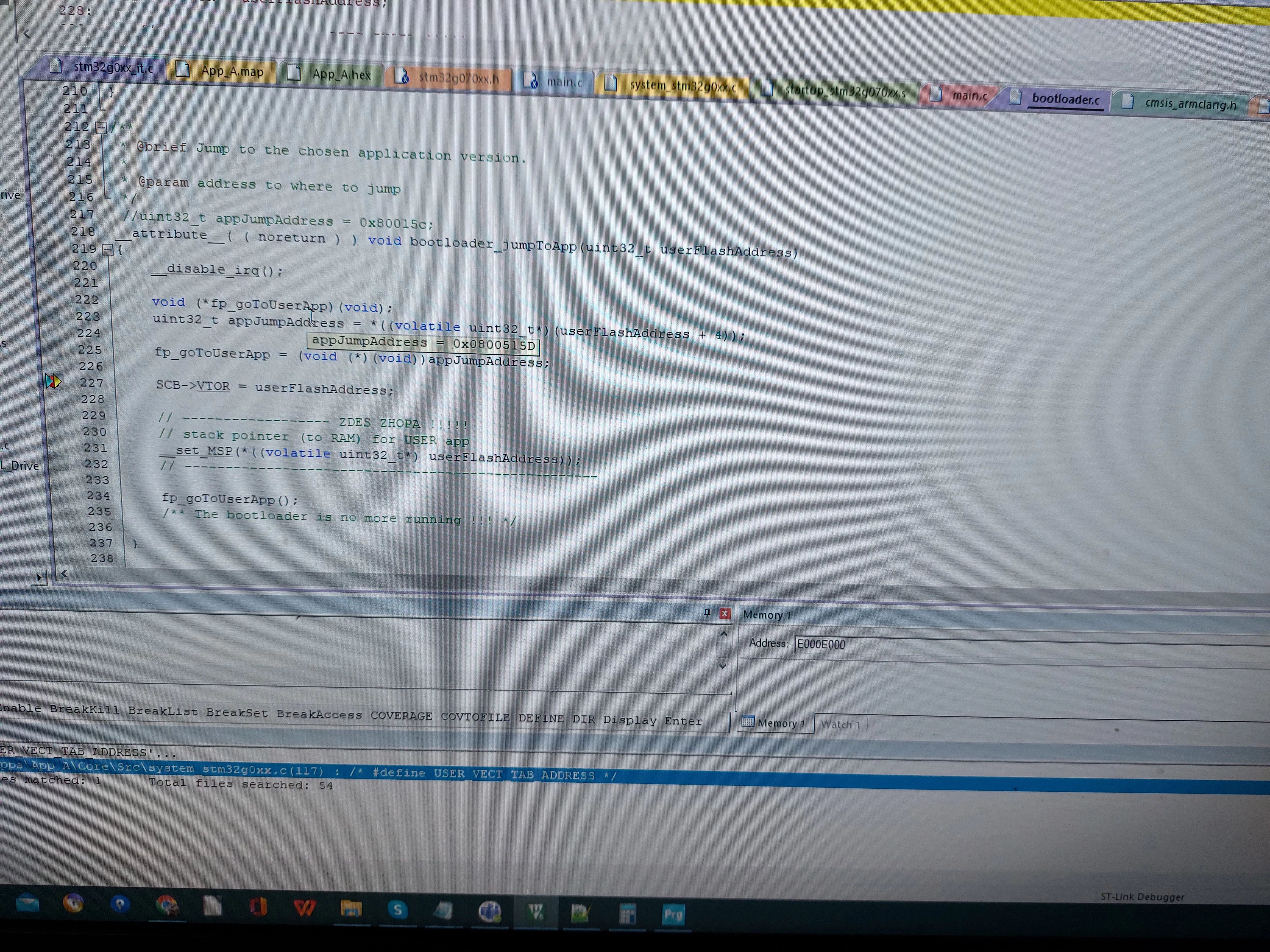

I am trying to jump from a Bootloader to an application. The scenario is very frequent and there are many questions about that on the web, but unfortunately I failed to find a solution to my problem. One of the problems I haven't yet resolved is corruption of the local variables right before the jump as result of __set_MSP which stores in the stack the base address of the applicatio, where I am trying to jump to.
You see here 2 pictures.
On the 1st picture you can see that appJumpAddress is 0x800515D, which is correct.

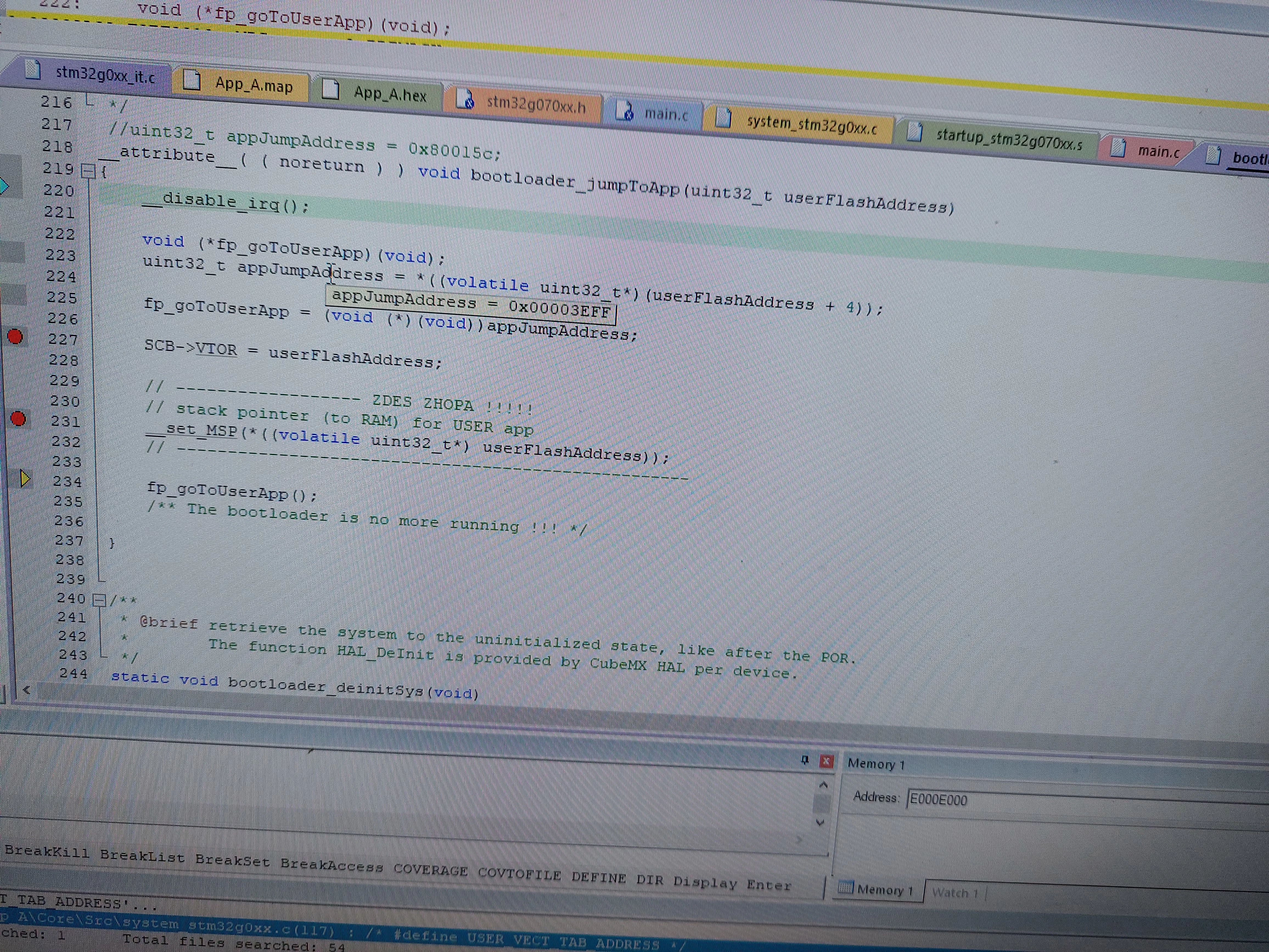

On the 2nd picture , after calling __set_MSP, written in asm, you see that appJumpAddress is already wrong and therefore my BL jumps to the wrong place in Flash memory .
The operation is standard , described everywhere. What I might did wrong?

No kidding... half this stuff is coded by people who barely know what they are doing.
The use of statics/globals would have been safer.
Look, don't set the MSP here, it's not coming back. Explicitly load the SP as the first thing you do in the Reset_Handler of the *Application*. Some of the GNU startup.s examples do this.

Also the interrupts shouldn't be disabled at the MCU level, nothing enables them again.
And don't change the SCB->VTOR here. That should be handled in the App side SystemInit() with a symbol the linker can fix up.

Actually, SCB->VTOR I changed in the SystemInit in the App, because Keil changed it to the FLASH_BASE which is 0. Thus, setting VTOR before the jump is redundant.
