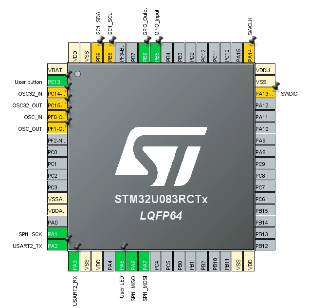

I have to interface the nucleo-u083rc with ads1293 to get ecg data. I have provided the code from stm32cubeide and also the ioc picture. I have connected the D4 pin(MCU) as DRDYB pin and SPI1 and I use channel 1 from the sensor. Please help me with the code to get things right.

ioc image:

Pavel A.
December 28, 2024
Which things are not right?
Here you can find enthusiastic help for your issue.
December 28, 2024
I couldn't read the data. I don't know how to figure it out as I am new to this sensor interfacing.
