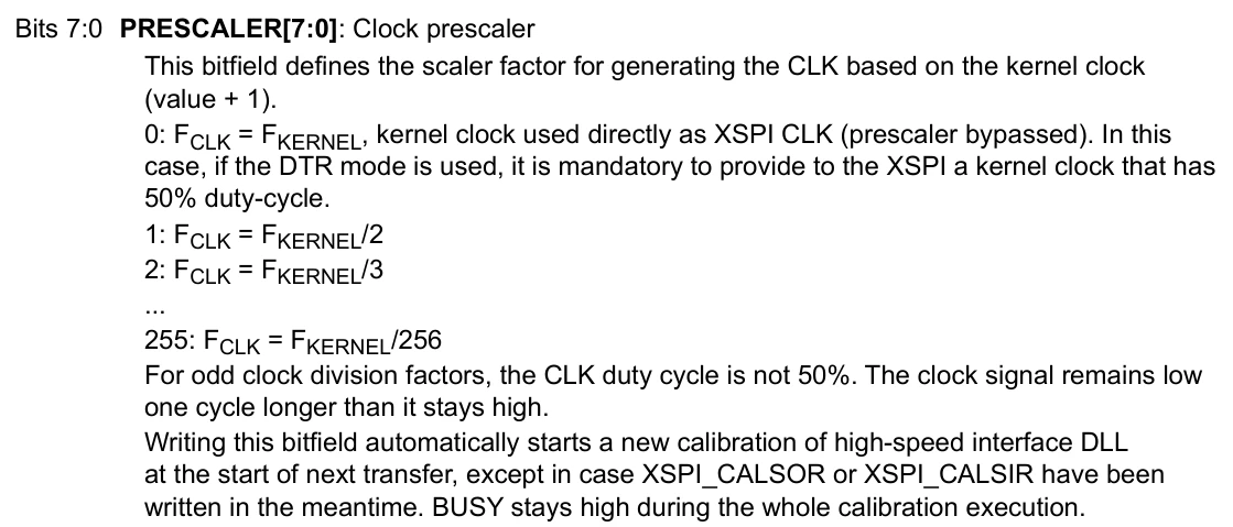

I'd modify the PRESCALER field in XSPI->DCR2 directly. Set the prescaler so that 100 MHz is generated during initialization then cut it in half after switching to high speed mode.

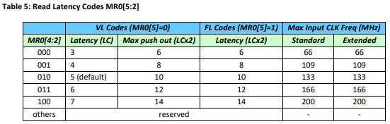

With this I am able to  go from a Clock of 100MHz (16), to 133MHz (12).
The RAM is responding at the higher clock, although at 200MHz (8) it is not responding and `APS256_ReadReg()` fails.
I am testing through different RAM Mode Register configurations to get 200MHz working.
February 13, 2025
Just setting the field should work.
Haven't used the XSPI on the H5, but that's how similar peripherals work on other chips. Perhaps change in this manner from 1 MHz to 2 MHz and verify on a scope or logic analyzer that everything is copasetic.
